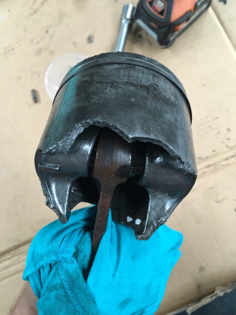

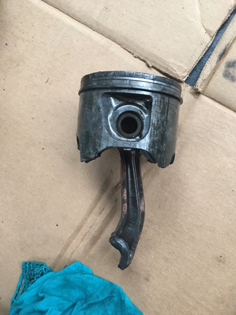

Hello everyone, I would like some help to know what's broken in my engine.
I have a 1999 Sea-Doo GTX Limited with 190 hours on it.
It had some water in it and I thought it was the battery and kept cranking. then took out spark plugs and spat all the water out.
once dry I put a cap of oil in each cylinder and dried the plugs and she started and ran perfect.
Then the next week it rode perfect for 3 hours, then the next day took it out and it stopes working after 10 mins. A lot of rattling and loss of power until the engine just got stuck. Now it only ticks when I press the start button.
I am able to turn the engine over probably 280° by hand from the shaft.
(Removed the head to see Pistons)
One piston moves freely as I turn the engine over and the other piston is jammed but does move a little, (maybe 1cm up and down)
When I shake the ski there is a lot of water in the engine which splashes out of the cylinder when piston is down.
Should I do a full rebuild or just replace the few broken things?
Is it just a bent Conrod? Or?
please your help would be muchly appreciated :)
Sounds like rebuild or replace. These engines are known for throwing a rod or balance shaft.
Water in there is concerning.

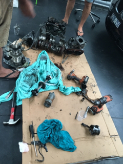

best way to know is to pull the engine, remove cyl's, split cases. very likely the crank is toast but you won't know until then.
you'll also find out of the cases are damaged, that would be more bad news.
Is that what hydrolocking is?
Bent the rod because of the water?
Yup. that would be one of the first things to fail.

The engine did receive some water a week before it happened.
I did the same thing in the video until no water spat out, dropped a cap of oil in each piston through the spark plug hole and it kicked and ran fine.
would you say all the water in the engine right now is from last week and it's built pressure and hydrolocked?
