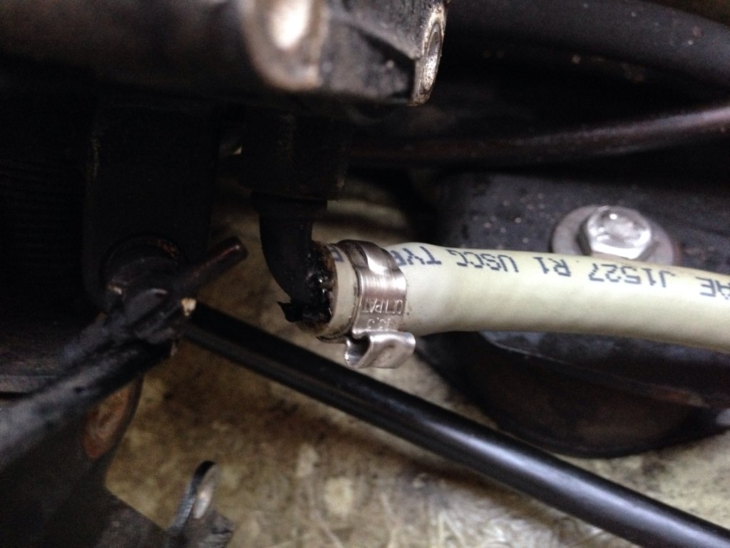

I just finished replacing all the dreaded Tempo fuel Lines on My GTI's. Took the first one off and examined the Tridon Clamp. I figured out an easy way to get them off. You need a good pair of needle nose pliers and a small fine flat blade screw driver. The last hole in the band of the clamp has a little prong that is bent toward the lenght of the hose. Using the needle noses you hook one blade on hose side of the prong. The other on the edge of the band toward the end of the hose. Bend the prong up straight. Pop the top band up with the screw driver between the two steel bands. Takes ten seconds to get them off. No struggle or trauma to the fittings.
Easiest with regular wire cutters.grab it where the little tabs hook over, squeeze and twist. I did the whole fuel line system with the other method mentioned. Then discovered this and it's Soooooo much faster and easier.
Ah yes, the clamps I refer to as the clamps from hell. All I have found on my older skis have been loose, but not quite loose enough to just fall off most of the time ... just tight enough to make you tempted to use more force than needed and break something.
2 methods shown have worked for me. One is to use (sharp) dykes and clip thru the top band. Other (I prefer) is to use flush-cutting dykes to lift the bent over locking tab then use that tab for leverage to lift the band up over the tab.
Hopefully the pics explain better.
