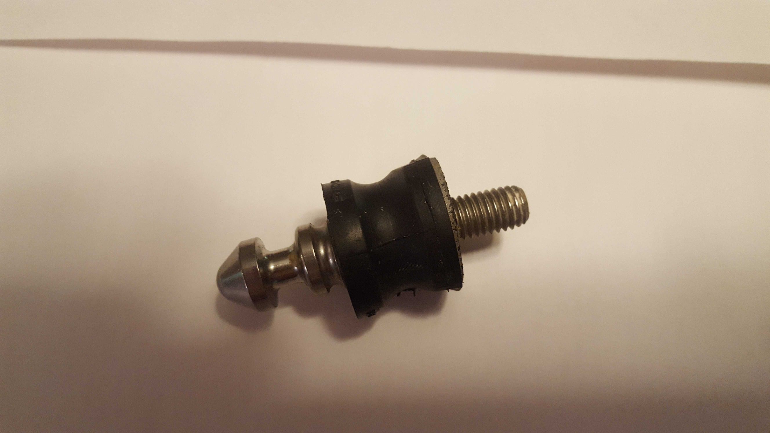

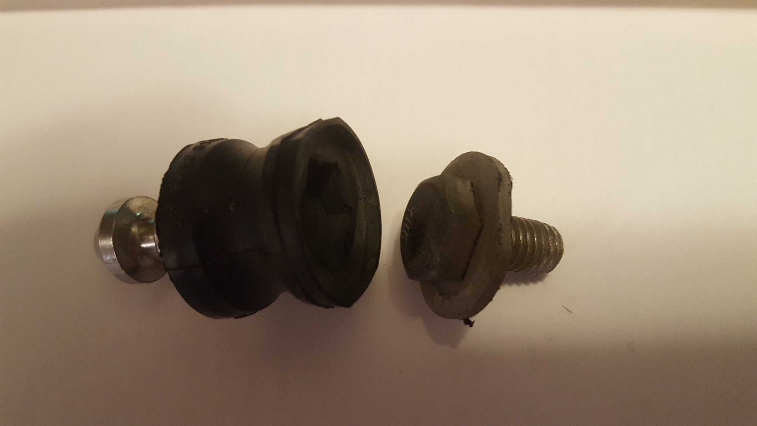

Here is the failed latch stud

I cleaned the ends very well with acetone then let it dry. I used Gorilla Glue and placed in a vise until it cured.
I had it back in my boat for about a month with no issues. However if it fails I'll update this post. Fingers crossed[emoji13]
