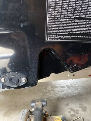

Yes, but you better make sure the wiring harness has the connector already wired for it which I think it does. Look at the rear of the engine on the right side down low and you should see a 3 wire connector zip tied to a cooling hose at the bottom that will have a dummy plug in it. That is the speed/water temp sensor connector.
