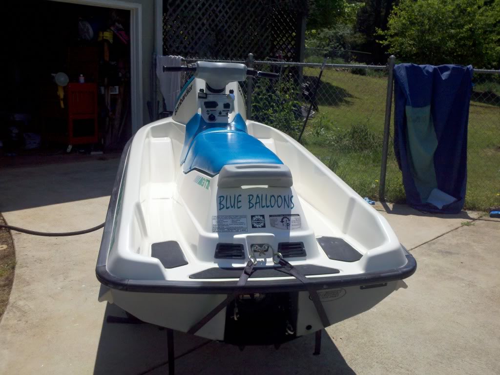

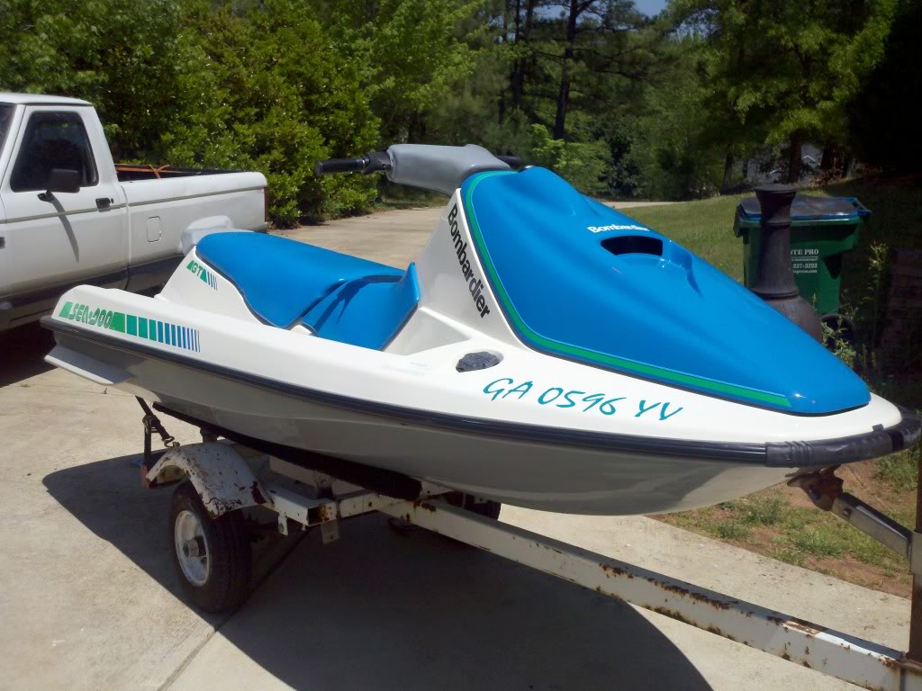

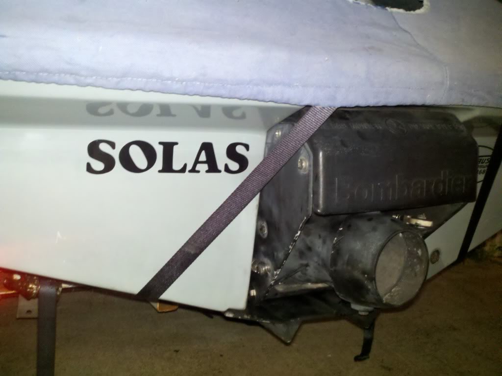

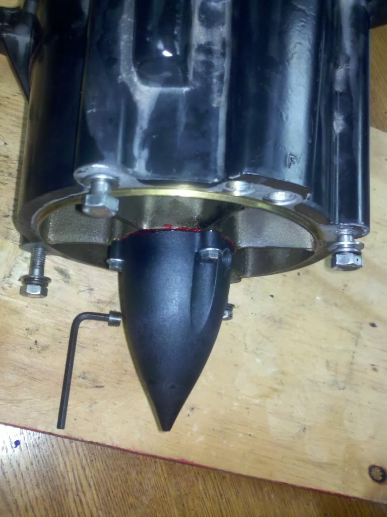

i just took my sea doo out yesterday to test out the repairs/upgrades i made in the passed few days.

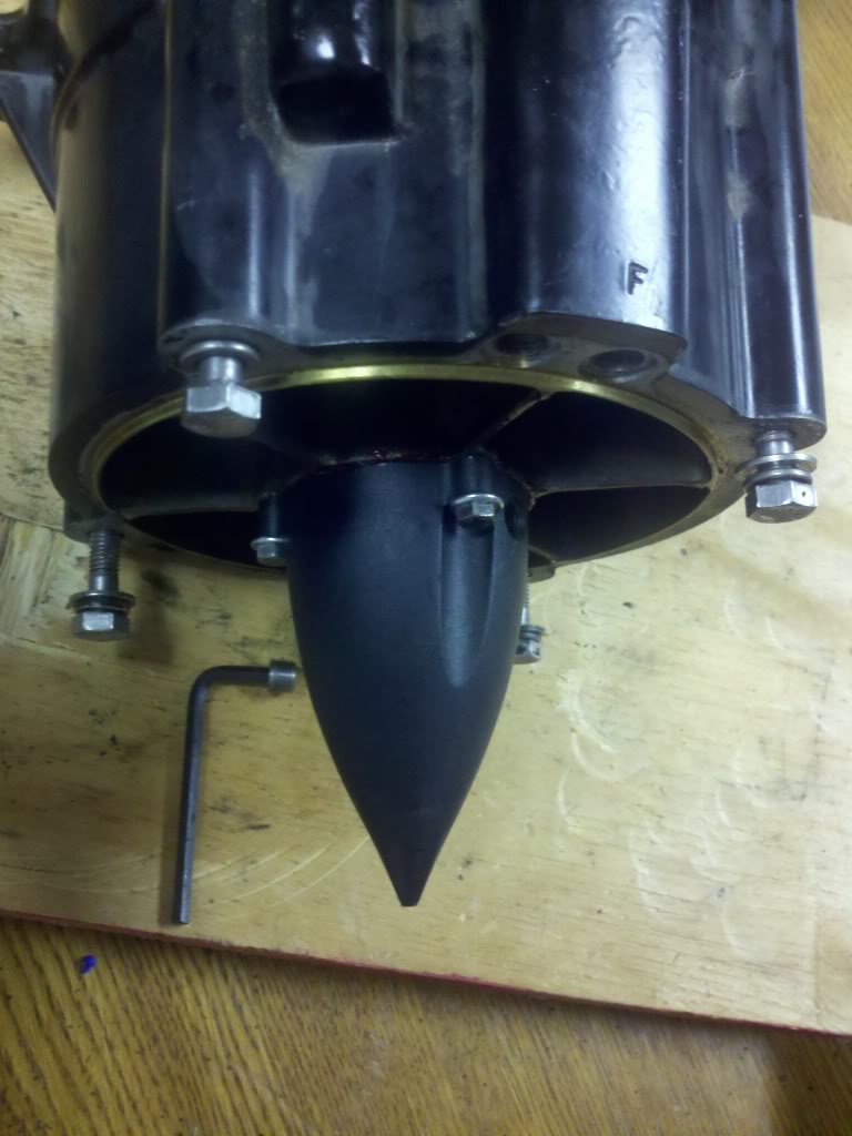

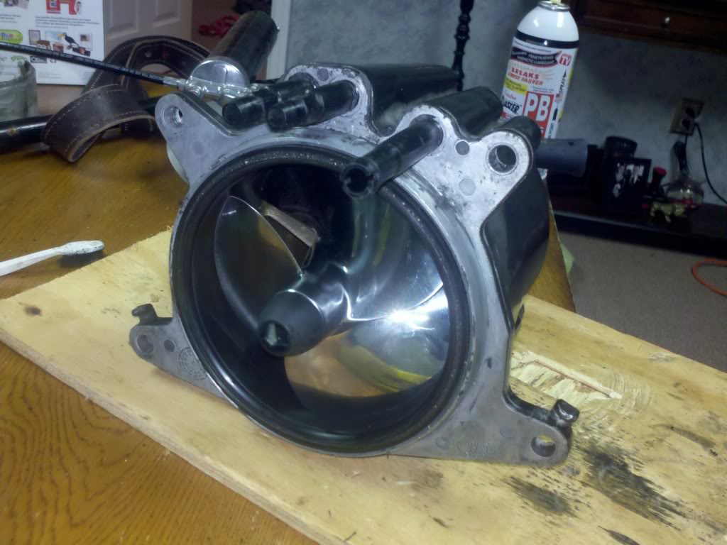

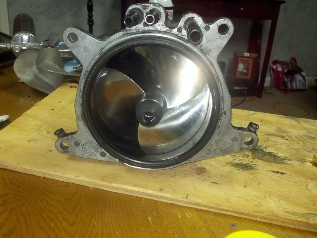

i bought a solas concord 13/21 impeller, oem wear ring, anti rattle cone, along with new seals, rings, lubes, and gaskets.
it was cavitating HORRIBLY the first two times i took it out. i had never owned or ridden a ski before so i thought that was just how it worked. after alot of research and asking around i tackled the project myseld and DAMN! she's ALIVE!... it will do a spin around with minimal effort, takes off outta the whole like crazy, and just flys top end. it was an amazing feeling of success yesterday to be able to do this myself and have such great results.
(i know, i know, its an old ski, its big, its slow, it sucks compared to yours, i know, i know... so please just resist the temptations... lol jk)

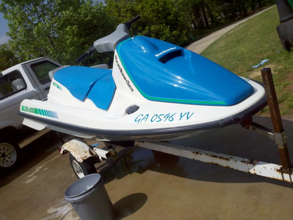

i also spent the whole sunday last weekend buffing and polishing the old girl to bring back her shine while i was waiting for my parts to be delivered.
i need some advice on refurbishing the topside of the black hard rubber bumpers, they are a lil rough and now have some compound on them that i cant get off.
i am thinking that i should wet sand em and look for some dye to make em deep black again. i have some "black" wax from my black box wax kit that i was thinking about putting over the white compound and see if it will wax out after i wetsand em.

My old Si has a Solas impeller. They work very well on the older skis... and help with the top speed. My Si from the factory is only supposed to go around 38 MPH, but with no mods, and just the Solas impeller... it will do a solid 45 mph.
Ski looks good... now you just need to paint the trailer.
Back to black from mcQuiers will make the black trim look great. What pitch solas did you go with?
i got the solas concord 13/21. it seems to be an awesome match.

and as for the black trim. the mothers back to black, and the turtle wax trim restorer were both useless.
so i tried some of my turtle wax black box car wax i use for my black crown vic u see in a couple of the pix. its a black precleaner wax, black carnuba wax, and a black spray detailer. its all actually black and worked amazing! the trim looks new besides the chips and bumps in it. it is shiney and deep black. just an idea to pass along to any of yall. it erased the white wax and pretty much redyed it all black again.
