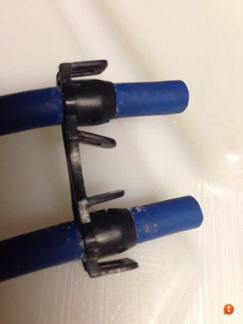

I have a 1997 Sea-Doo Challenger 1800, twin 787s both replaced in ~2008. When I got the boat (last season) the stbd engine ran fairly well, and the port didn't run worth a damn. Both engines have 145-155psi compression, I've rebuilt all 4 carbs, (mikuni kits) pop-off is ~30psi on all four, High and low speed adjusters set to spec, idle set to ~3k out of the water and settles nicely around 1500 in the water, trimmed the plug wires on both engines, drained-cleaned- refilled oil tank, drained and refilled fuel tank, checked oil delivery, adjusted pump, adjusted both throttles (dock assist too) everything seems good. port engine idles a tad rough, but both run well now- full throttle application results in a fairly brisk acceleration to a little over 7k rpm on the factory tachs (fairly close to my digital 'tuner tach') and the boat quickly jumps on plane and accelerates to around 50mph on the dreamometer. Couple issues; when pulling a tube with two teens on it, port engine went to 5k at full throttle, stbd went to 7k. when we crossed some wake and the port engine encountered air (unloaded briefly) it accelerated to 7k and remained there until I pulled the throttle back a while later- the kids were enjoying the added speed(question is- why wouldn't it accelerate until it was unloaded?). My second issue; when we stop for a while (or I 'kill' the engine by accident) the port engine will start right back up unless we wait more than 15min or so- then I can NOT get it to restart until it cools completely (HOURS). Finally, the plug wires on the stbd. engine appear to have a true metal core like racing wires used to have, but the port engine has the carbon looking core which is right?
So to restate my questions:
1: Suggestions as to why the port engine wouldn't reach WOT rpm until it was 'unloaded'?
2: Any idea what might cause the 'no restart' issue when the engine is good and warm?
3: Can the plug wires be replaced independent of the coils? What type of wires should I use (would automotive metal core performance wire be ok)?
