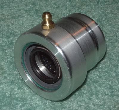

Seal direction, please help. This is the only thing hanging up my install!
ksw144
Is this seal installed facing the correct direction? I can't tell from the shop manual. based on the manual, it looks like it's facing the wrong way, but the other way would be backwards to my thought on it.
Thanks,
KW

Looks backward. The lip should be facing out, (on both ends) and the metal can should be by the bearing... like this:

OK... most seals are designed to seal in one direction. (well... hold pressure in one direction)
By facing both seals out... the seal toward the pump will hold any water pressure out of the bearing. The seal on the hull side is to keep the pump from sucking the grease out of the bearing. By running the hull side seal backward... you may suck all the grease out, and you may have cavatation issues.
Since it's a brand new seal... you could probably get away with it for a couple uses. Just bring a grease gun with you, and make sure you keep the seal pack greased.
That makes a lot of sense Doc, I'm going to order the new seal standard shipping, see if I can get my stereo finished for the weekend, and make a test run to check for water in the boat. At least with the new correct seal on the pump side I should be keeping water out, which is my number 1 concern right now...
Thanks for the explanation, I'm slowly wrapping my head around the way this thing works.
