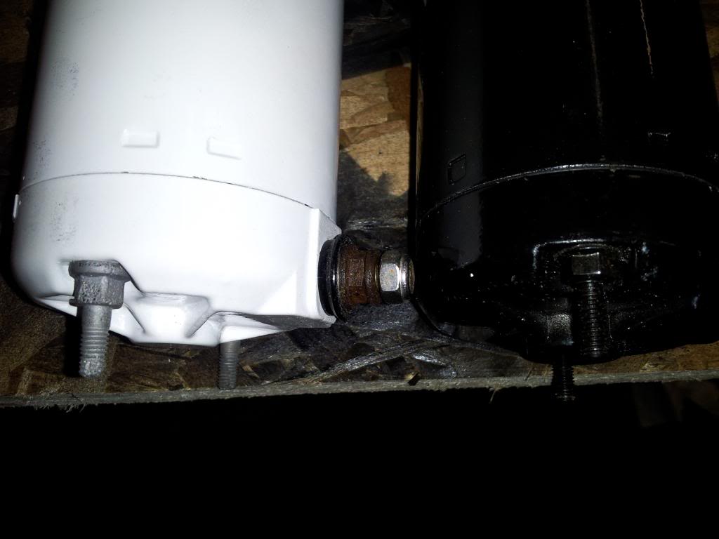

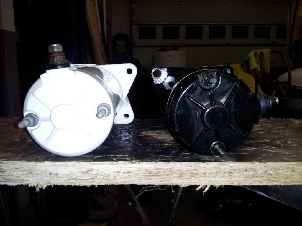

Here's my take and I have posted this before. I wouldn't say the cheap starters are junk per say. You really need to pay attention. The biggest thing I have seen is the studs. On the OEM starter the "nut" end of the stud measures almost .300", the after markets are a full .100" shorter, almost 1/8"!!!!!! So when you put the rear bracket on it will hit on the 4 angles running out from the center of the end cap and will cock on the back of the starter. Then you don't realize it when you tighten it up cause you "assume" it's just like the OEM starter. Then the rear bracket hole won't line up so you loosen the front mounting bolts to help you align the rear bracket cause your so pissed off working on the starter. So you tighten the rear bracket then draw the front back in, and it's probably cocked so the bendix isn't parallel to the flywheel. So you get a hundred or so starts off it and the shaft snaps and we blame it on the starter, rather than the install itself.
These are just my observations, not sure if it is 100% the case but if you do a bad job on the install, you not going to get the life from the starter. I'm NOT DEFENDING the import starters, I just think they are improperly installed.
Also the 720 Starter is not clocked correctly, your hot lead is going to be on the way bottom of the starter, so either remove the long studs and clock the FRONT NOSE in the correct location or just deal with the stud on the bottom. If you choose to leave the stud on the bottom, hook the cable up first. And obviously the nose is not tapped so you get to wrestle with nuts and lock washers.
Here are some pics. The white is a restored OEM starter, the black is the import.
