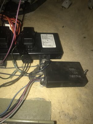

The 'Throttle Guardian' is an add-on (not everyone has it) electrical box that cuts/interrupts ignition if rev'ed too high in neutral... (not 100% sure about this... I don't have one). All recommendations I've read say remove it. Pics I've seen show it behind the helm next to the helm fuse box.
Yeahhh I have it. I will disconnect it to see what happens.
