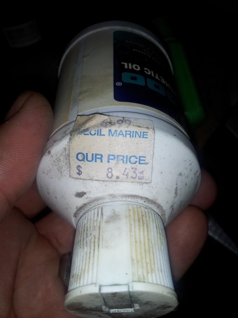

They're not guilting you into it, they are "selling" it to you. Personally I use it, just because I bought a bunch of it years back for $8.43 each (NOT A TYPO) and haven't gone through all of it yet. LOL Just look on Ebay for stuff and when you see a deal you have to pounce on it, I'm sure at some point some guy will be cleaning out his garage and put a few bottles up for cheap, it's called inventory, buy in advance, stock up, whatever you want to call it. You can buy it on Ebay right now for $15.99 shipped free.

Yep, if you look at the price tag it says 6 99. I bought a bunch in August of 99' and am still working through it, LOL.
