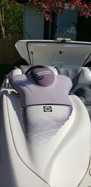

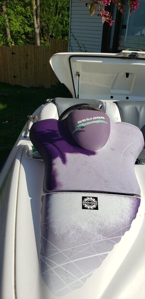

Decided to take a shot at restoring the plastic on my 1995 seadoo speedster twin Rotax
Turned out great cant believe how easy it was with the heat gun took me 20 mins

Looks awesome. I bought a heat gun last night to donthe same to my faded 95 XP. And tips or tricks to advise?
just go slow and dont stay in one spot too long with the gun its better to come back at it for a second run with the gun and do it outside not in the garage so you not breathing in the plastic fume :P is really easy just keep gun like maybe 3 inch away from plastic is what I did. The gun i used had 5 heat setting i was using #4 pretty hot so didnt take very long did 2 passes.
