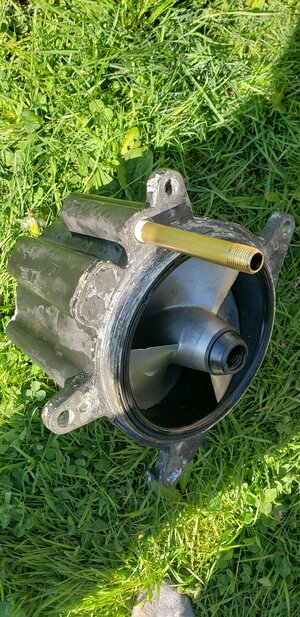

1995 seadoo speedster twin rotax was removing the jet pump / drive shaft to prepare for carrier seal replacement didnt realize there was a threaded plastic connection connected to the jet drive explains why was so hard to pull the housing off the shaft lol.
anyone know what this part is called so I can find the replacement or possibly I can just browse around the hardware store isle to find a replacement part made out of metal instead of plastic.
pics of broken fitting was able to get the broken part out of the threaded area

added brass fitting seems to fit the same will put a coupler on other end so can be removed inside engine bay

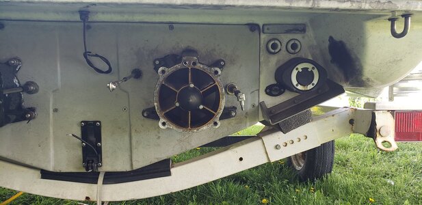

more pics

Need some o rings as most of them are dried up there is also a weird looking o ring around the impeller area where the shaft inserts anywhere still sell these you guys know of lmk that would be much appreciated!
guess its some type of bilge pump tube I found the oem part and ordered 2x lol takes a while to arrive but waiting for the carrier bearing anyway
