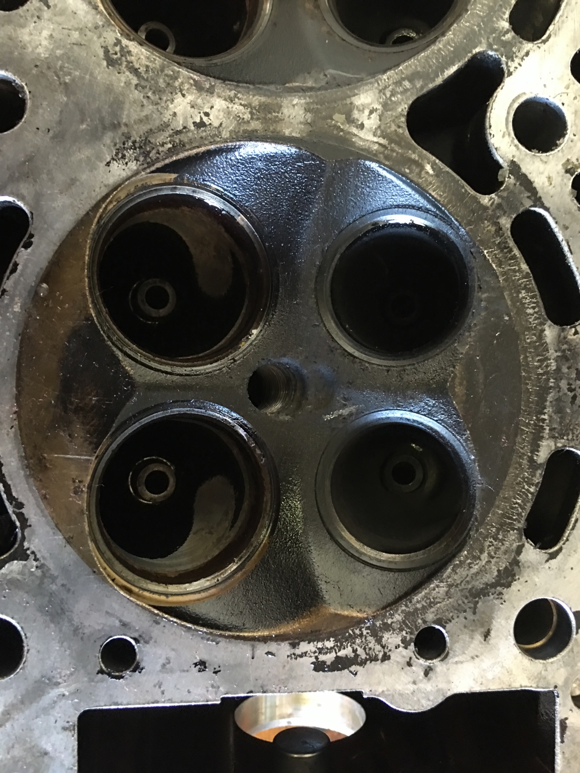

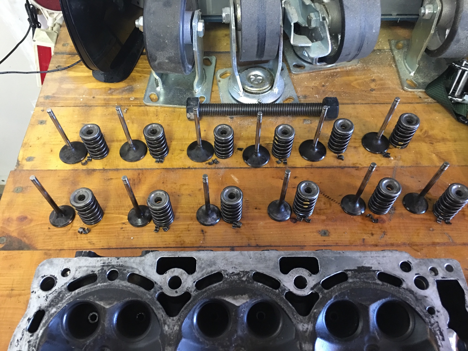

Pulled the head off what do you think
Kashmoney
05 RXT

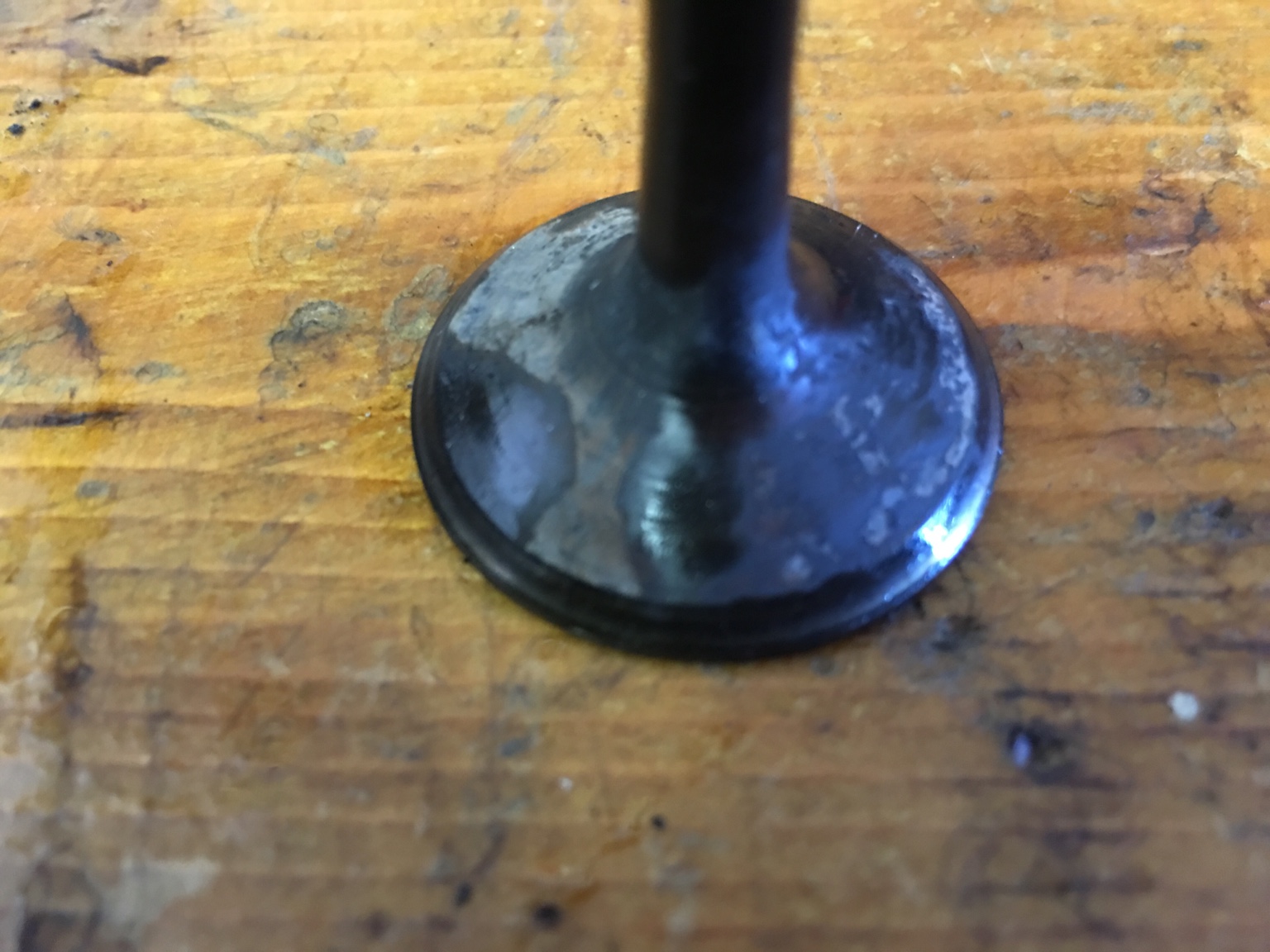

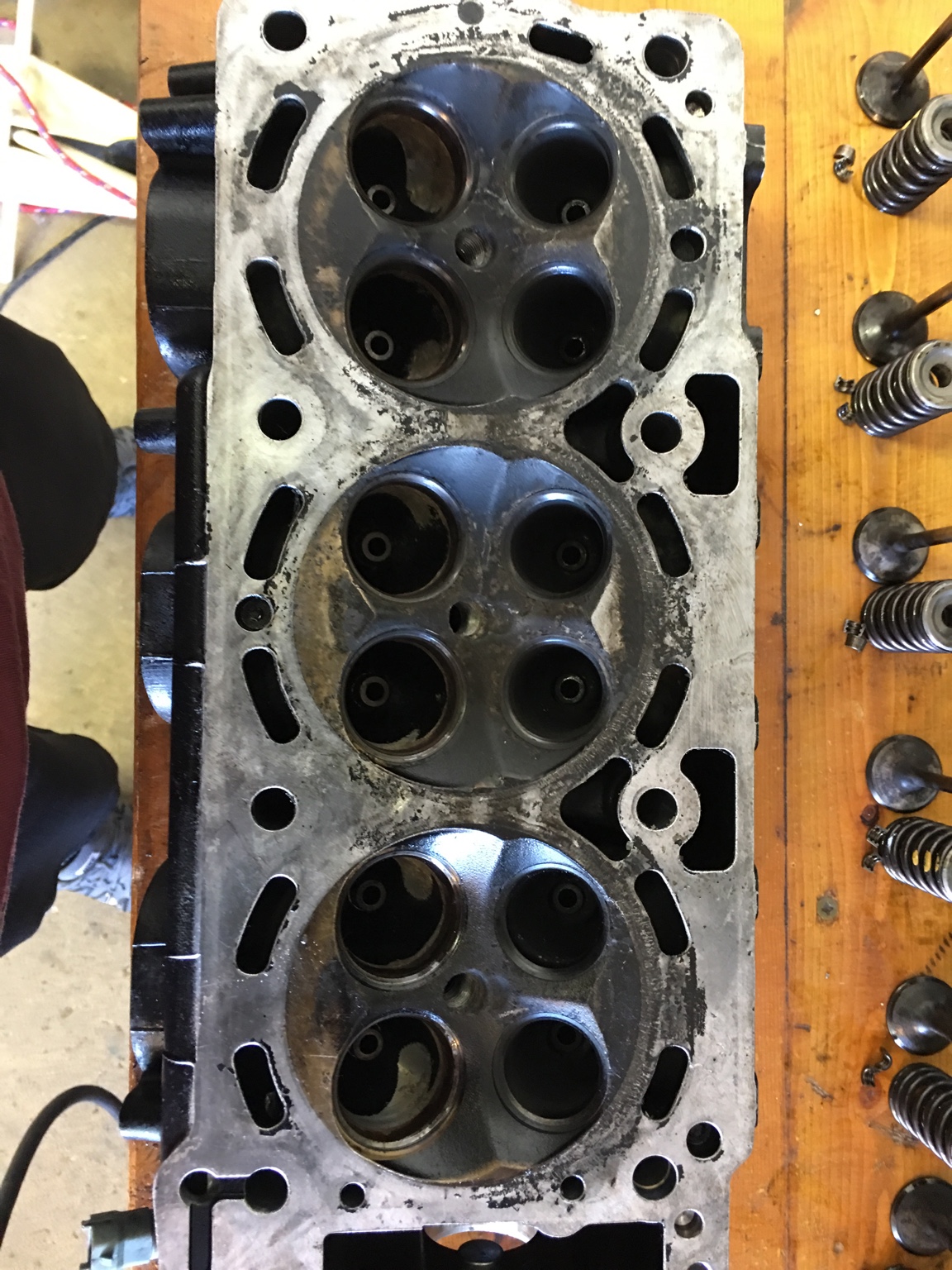

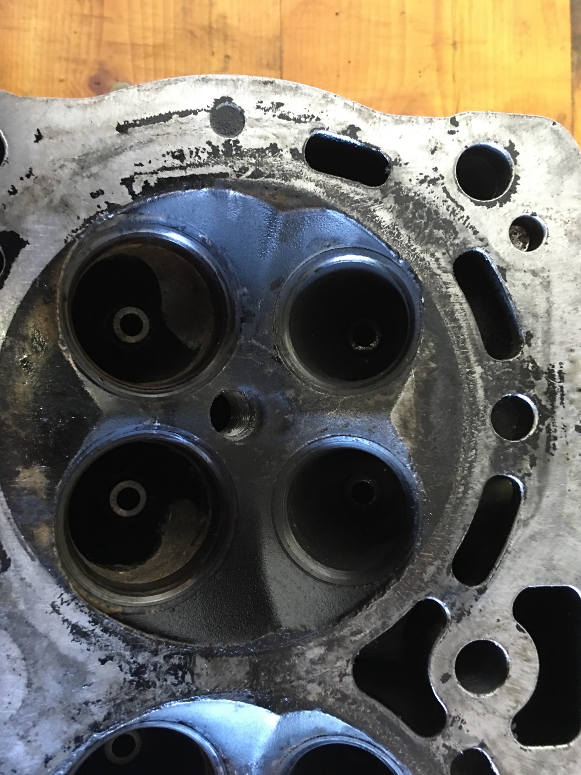

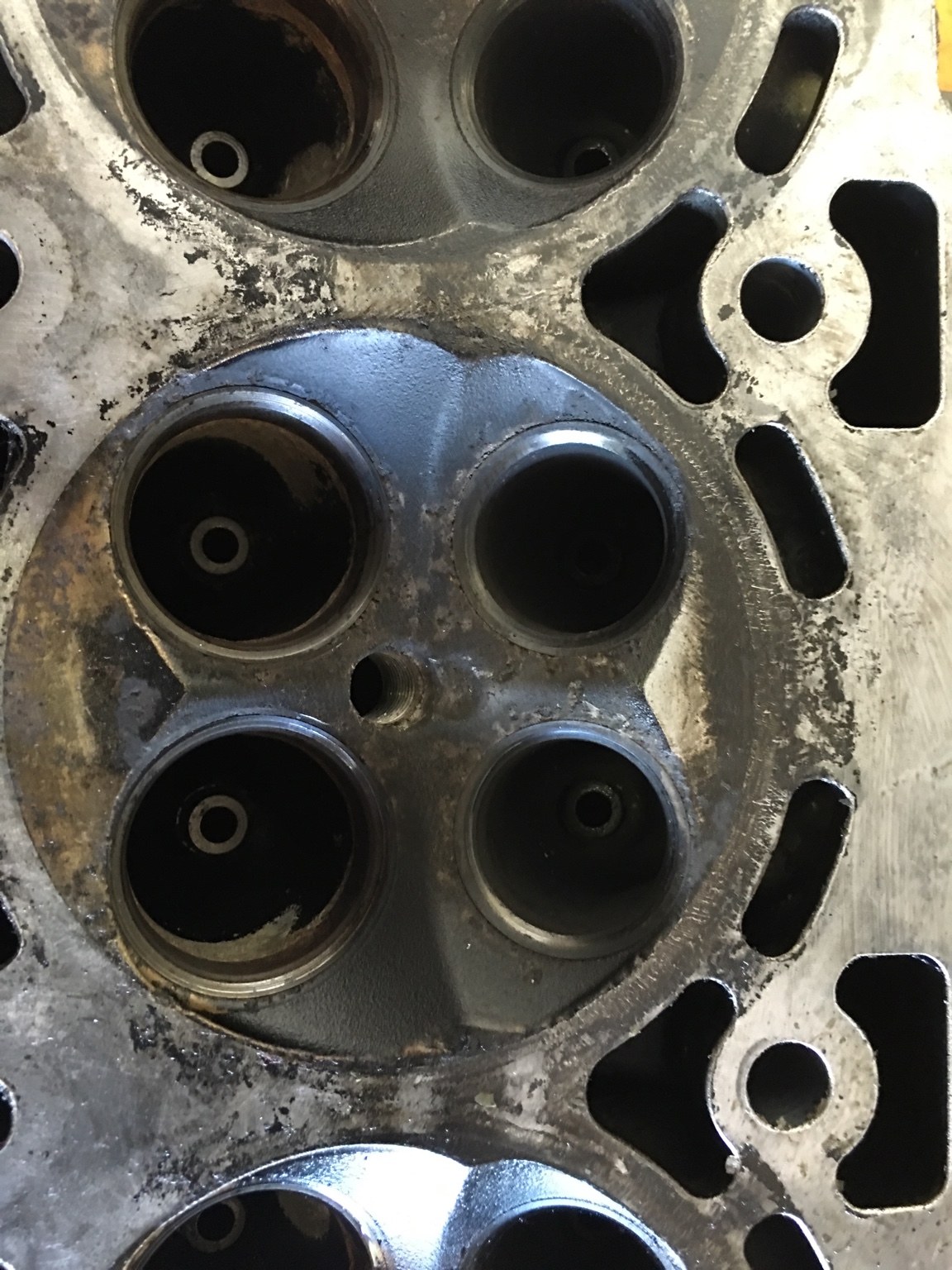

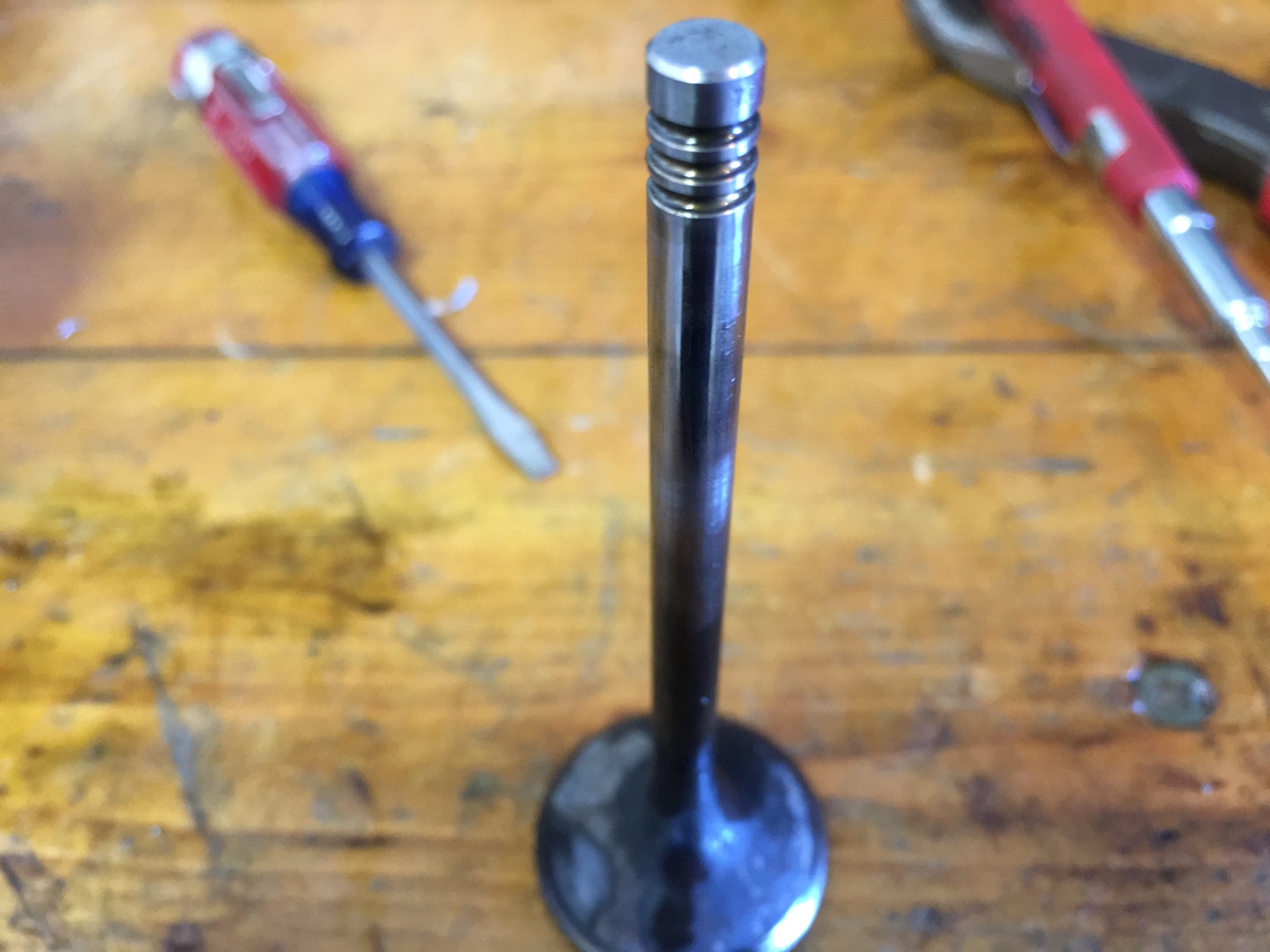

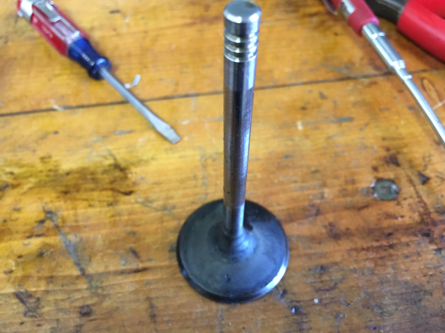

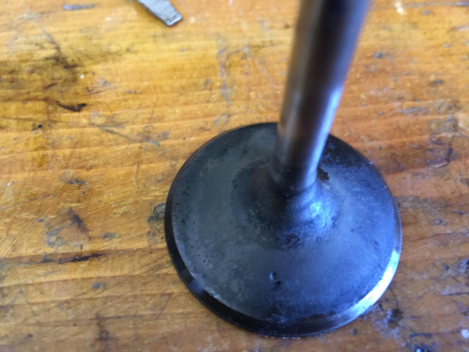

So I had a over heat is sure which led to a no start. Low compression. Pulled the head off. What do you think of the valves head and what not. Any advice appreciated.
At the top it's stamped 72524 tk. There in good shape tho no corroding or rusting no cracking[/QUOTE
You do what you want, but if it were mine, I would replace those in a heart beat. That part number is Sodium Filled. Do a google search and you will see there is a TON to read about them. They fail and cause very SERIOUS engine damage. It can easily cost 3 grand to fix it.
The valves with the number 75 stamp are solid core.
Seadoo had a lawsuit in regards to the 72 version and no longer use them..
IMO, now is the time as you have the head off...
