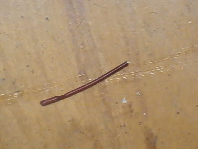

Here is the tube after I pulled the top plate off of the head. I found it inside the exhaust port. It tried to make it out of the exhaust.
This is the actual size of the tube. Nothing was broken off of it. The way it got smashed somehow is why it looks like that. Maybe the kids hit the start/stop button when I wasn't home. I pulled the battery so that can't happen. I don't know. I had to pull the head top plate to get it out. Found it in the exhaust chamber. Lucky me?
You know, it may have just melted or got chopped up and gone through the exhaust system if you had just started it up. But getting it out is the safe thing to do.
