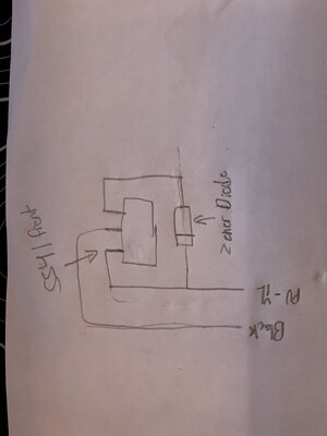

I never got down to my shop this weekend but id check the wires and everything. If your speedo unit is bad your going toi need a SS41 hall affect sensor and a DIODE ZENER 5.6V. If you find that you need it heres a diagram of it.

Im not sure how to test the actual gauge but to test the unit stick a multimeter into the connecter of the unit and spin the wheel. Voltage should fluctuate.

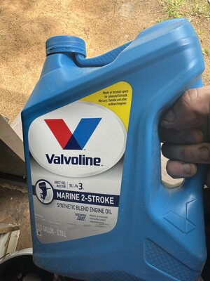

Hey here is some photos of the oil tank ???, and the oil for the sea doo, I didn’t want to go dumping stuff in until I shared it with you, sorry it took so long. If I hear back today I can just fill the oil tank and ride, the Speedo is going to take a while to fix

Totally wrong oil, do not use.
You need full synthetic API-TC rated oil.
Since you don't know the existing oil, you really need to drain the tank, replace the inline oil filter and put in new and correct oil.
Mixing two different brands can gel and clog the oil system and ruin the engine.
Is there enough in there to run them however, it doesn’t look like it’s out of oil?
