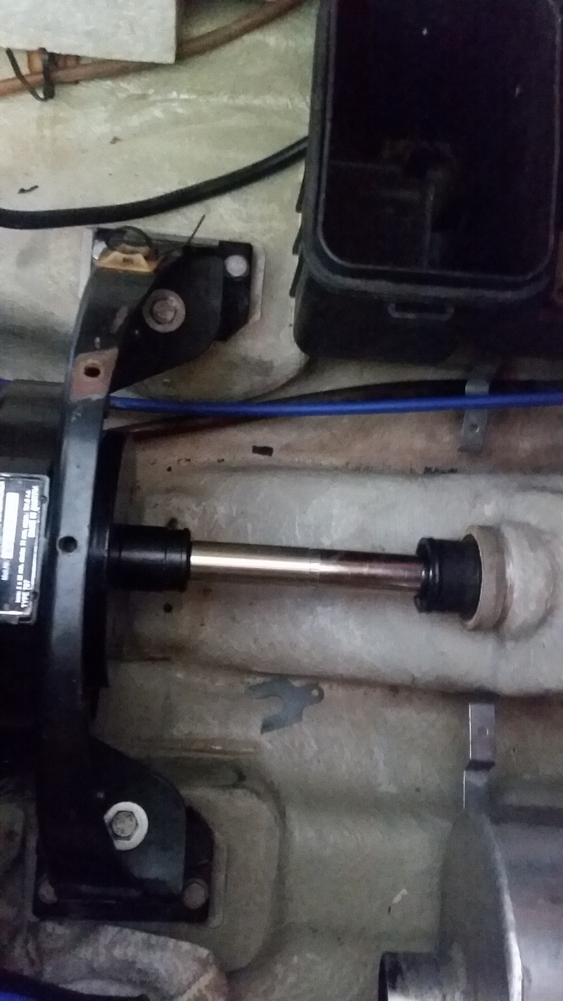

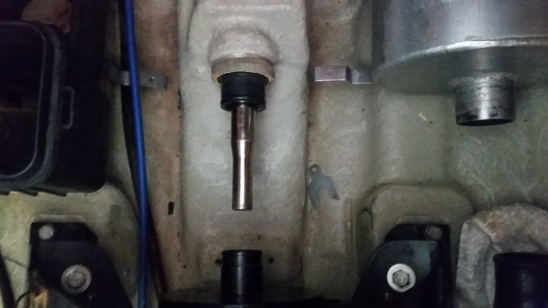

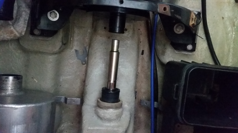

Which adapter do you use? 96 XP 787.?
This one? A.
Which fits like a glove..
or use just the rod itself?
My reason for asking is because i just got my shims today and have been trying to get this thing perfectly aligned and am having some difficulty. With the adapter on, it fits like a glove all the way through until the end of the pto..
With just the rod, i can adjust the motor slightly and make it fit like a glove also but not all the way to the back of the pto. It fits good past the splines , but not all the way to back as it gets in a bind, if that makes it more clear.
This one? A.
