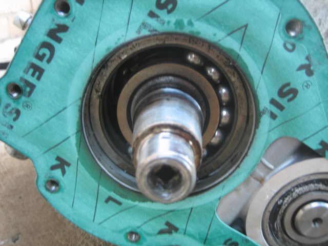

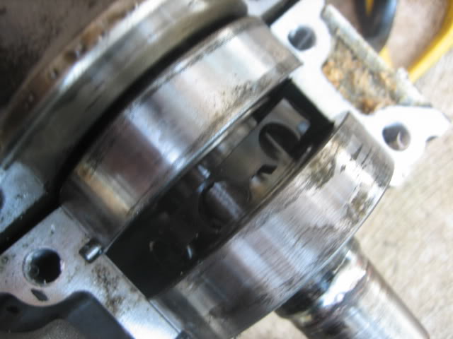

if the RFI is same as carb model CBS than from memory the 30mls of oil in the CBS can leak into the main crank compartment there was nothing stopping it if u have the engine laying on its side u might have no oil in there anymore
just remember a properly rebuilt engine will make no noises other than a pop and suck from the exhaust u shouldnt hear any ticking or bearing noises
just a thought heres a faulty bearing on a 787 this crank made a "tick" or ball bearing dropping sound when turned over by hand im not sure if SBT uses metal or plastic bearing spacers but the plastic sure is a .... design imo
