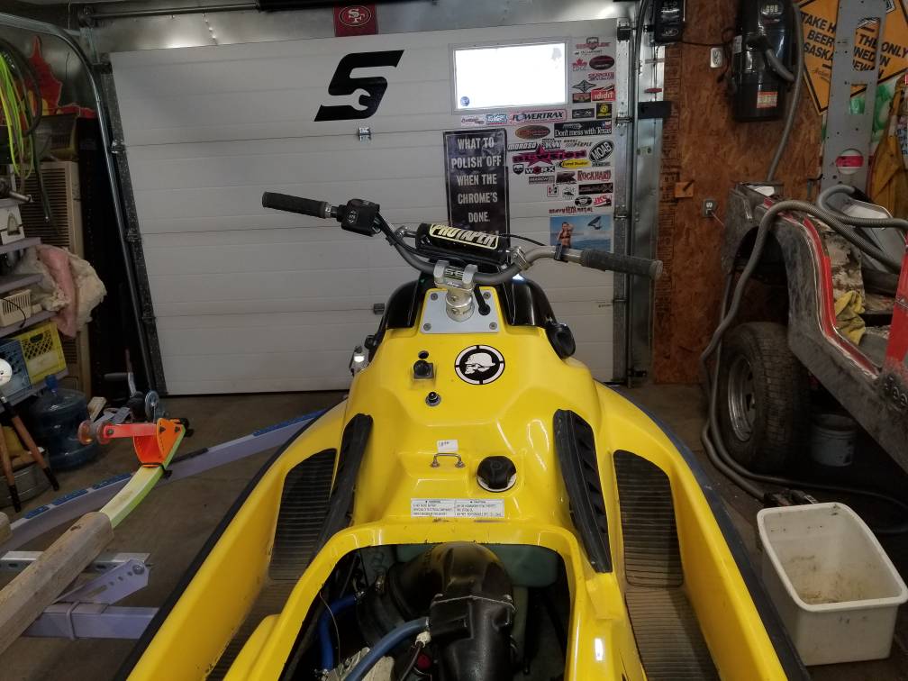

Have been out of the game for a couple seasons busy with the new cottage but I rescued this old race ski today guy said it just needs a starter which I have a couple so will see see what happens

Ya I've been looking for a lot of the parts on it because I'm to cheap worked out I guess. The starter wasn't its problem bad piston thankfully I have a couple

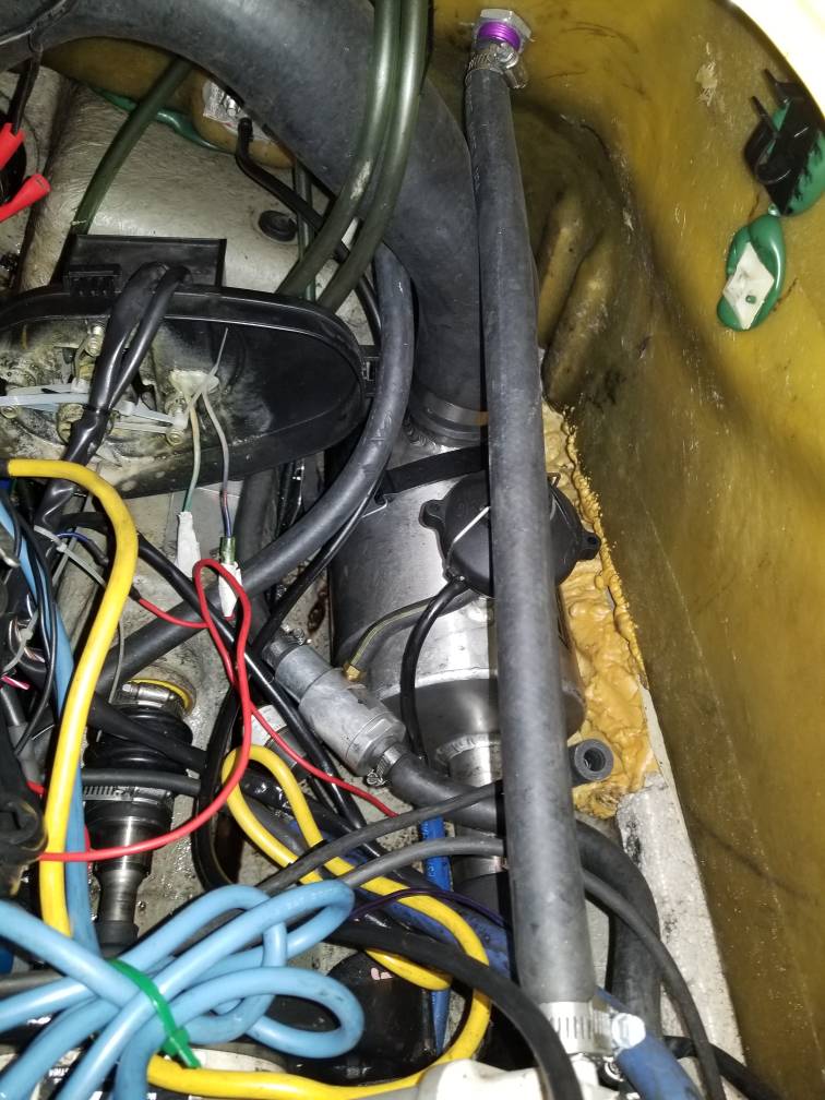

Kinda disappointed I think the crank is toast noisy and has a tight spot

Make sure it's not just the impeller rubbing on a dried out wear ring or something.

I wish it's out of the ski I'm going to have to split the case see what's going on in ther

Runs great still a bit of water jeting and a little fine tuning on the carbs but kinda blown away at how good all the setups working
