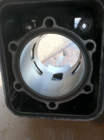

BEFORE
AFTER
Well... unless they are out of round... that jug looks good to me.
Go run it hard, and see if the compression picks up. Also... go get a different compression tool. Who knows... it could be wrong, or there could be a leak in it.

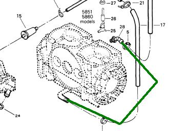

After leaving the ski alone for a day I decided to go back and check a few things before I put it in the water for the first time. When trying to figure out how the previous owner bypassed the oil pump I saw it. What a stupid mistake I had made. The oil bypass has a clear flexible tube that goes from one side of the engine to the other and it is a tight fit. When lowering the jugs over the piston I barely caught the edge of the tube so when I torque it to specs the tube got pinched leaving a very small leak between the block and top end. After tearing it all down and putting it back together, being a little more careful, I am getting equal compression of ~145 on each cylinder!!!
With the oiling system there is a clear tube (green line above) that runs from one side of the block to the other. I don’t see any oil in the tube; how should I add oil to it? Is it 2 stroke PWC oil?
Yes... it should be the same 2-stroke oil you are burning. Some people put a "T" fitting in the hose, and use that as a fill point. BUT... Like I said before... I don't like a loop of hose. If you have leaky RV or center seals... it will drink that oil, and you will destroy the gears. Put the tank in the hull. and hook those hoses to it. Then... keep a quart or two in the tank.
