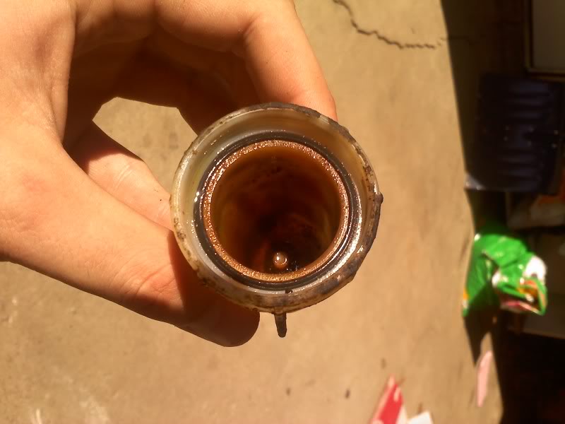

Fuel Filter Housing:
New:

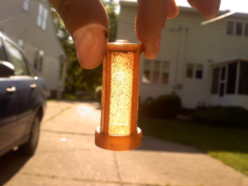

This is a before shot. There is a TON of sediment at the bottom of the filter housing!!!

This problem has been around since the 90's, although the water filter could be filling with steel gas can trash so that problem is about as old as gas itself - anyway you are on the right track to clean out the fuel system, remember the control switch, take it apart and use a cloth over a battery post brush to get the goo from there, and add a clear lawn mower fuel filter in the engine bay to get the remainder out from other places, there are small scrrens inside the carb inlet fittings which is the last place to get plugged with the fuel line goo and then it could have your carbs held hostage waiting for a thorough clean out of all those tiny passageways, catch the goo in the throw away fuel filter near the carbs. While you are in detail check out the oil filter.
Yup... that's ugly. I also run an extra in-line filter to get the fine particles that the plastic screen doesn't pick up.
Now... imagine what the little filters in the carbs look like.

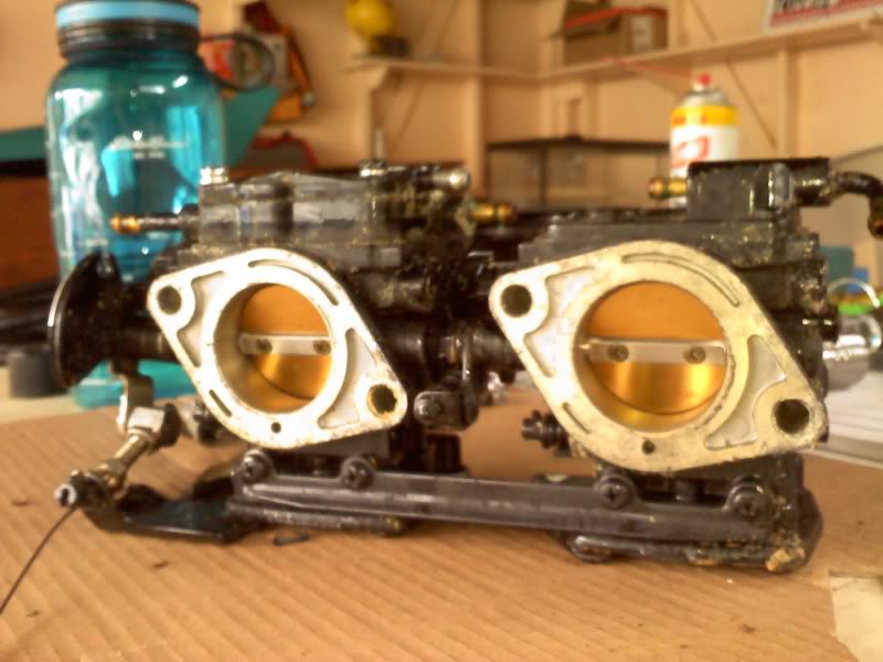

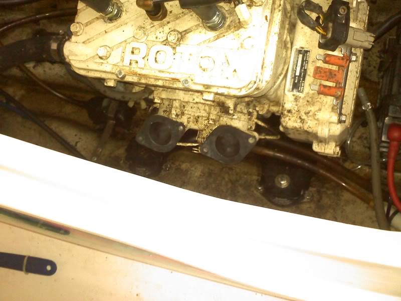

Carbs off of the ski
In decent shape, waiting to see how they are inside

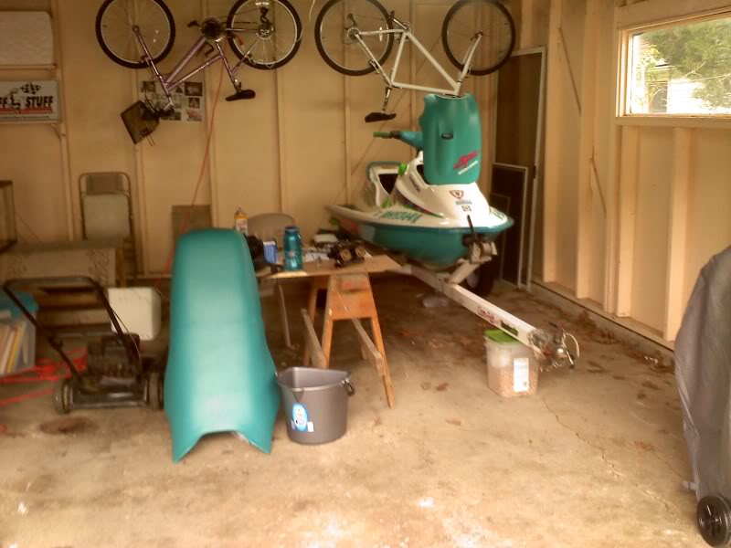

And how my ski has taken over the garage. Got the seat reupholstered, too. We can usually park 2 of our cars in the garage and have room for the ski and trailer, no problem. Wifey is not happy :-)

UPDATE:
Had a local guy rip carbs apart for me and rebuild.....The filter baskets were almost 100% clogged with sand and green goop!!!!

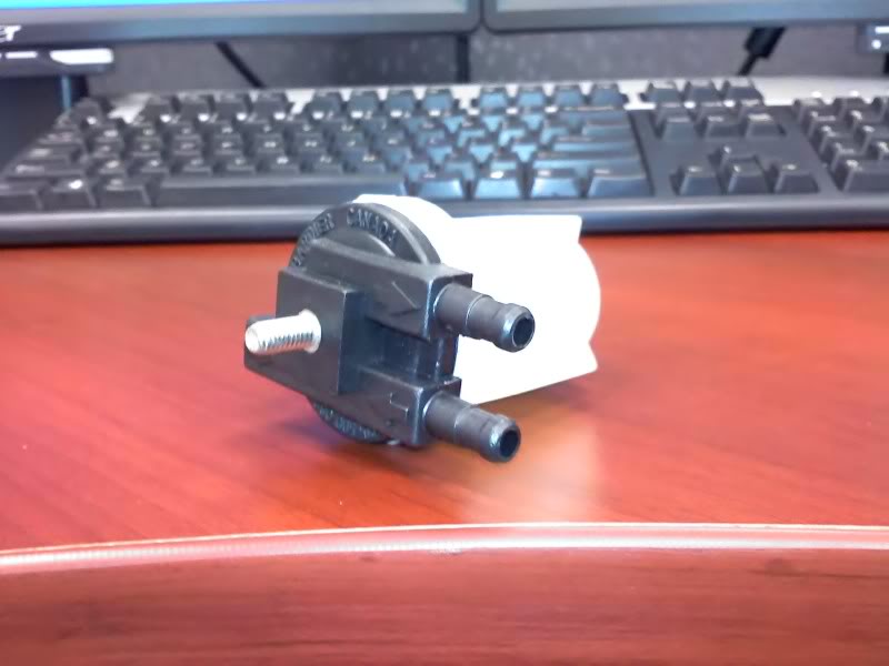

YES to SWAPPING OUT, not just cleaning the fuel selector switch. If it needs to be cleaned, you won't be able to clean it enough to make it work right. I did the entire fuel system clean/swap/rebuild and ignored the switch, on a stalling issue I had. After hundreds of dollars and many hours, it was a $30 switch that was the main problem all along.

Yes, like stated above seems as if just replacing these old junk selectors with an aluminum one will save a lot of headaches!!
Your carbs do not necessarily need to be rebuilt. If the core components are in working order, a good cleaning of the baskets and needle, seat, screws, etc will do the job.

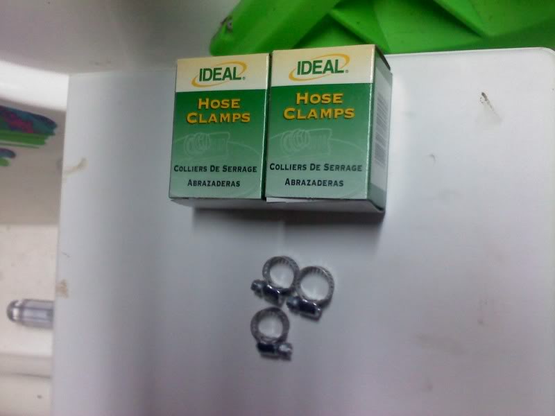

Here are the #4 worm clamps i'm using, from autozone. I think they were $0.60/each:

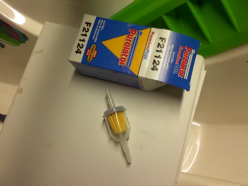

Also, I am adding this filter between the tank and carb inlet. It was a couple bucks and is made for the 1/4" fuel line i bought from Auto Zone as well:

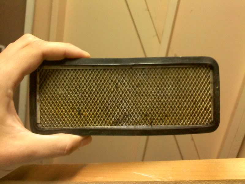

Here is a picture of my flame arrestor screen. Very dirty and is clogged with all sorts of debris.:

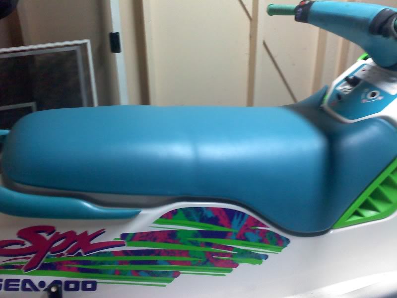

Lastly, here is my reupholstered seat. I bought the skin from ebay and had a local stretch it. The material cost $35 and the labor was $20, including all stainless staples. A new strap is on its way, too!!

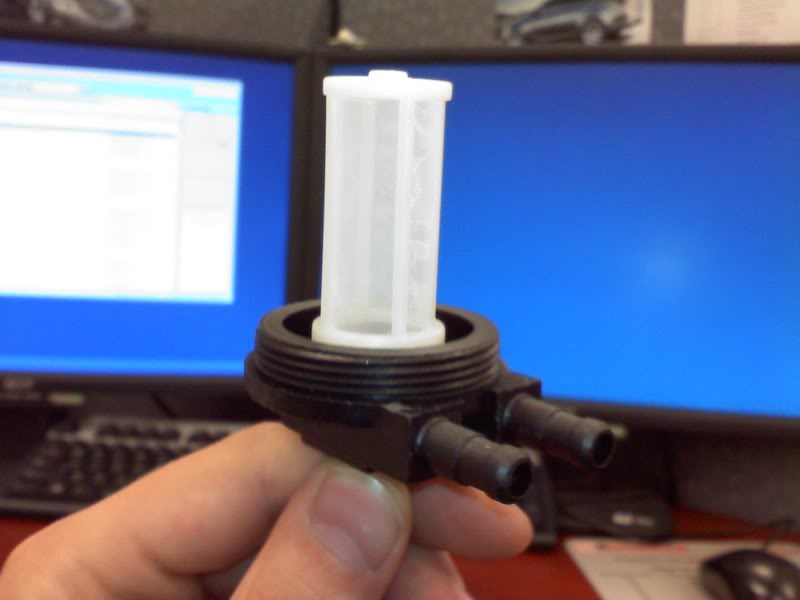

just for comparison, the new fuel filter:
Housing [Not orange like the old one]:
New filter [See a difference?]:
