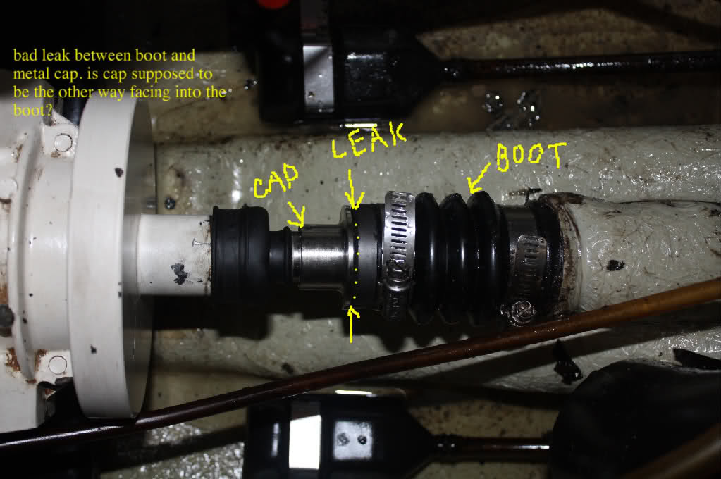

[/IMG]
mounted another mirror and finished motor swap. ran perfectly fine until it died because it was FULL of water and the battery was dead. we kept it on the trailer and saw there was a bad leak under ther the cover of the shaft. took cover off and was leaking between the boot and metal ring thing. have any input on how to seal the problem?
The carbon seal will leak a little. That's how it stays cool. But, if you push the stainless ring (what you are calling the cap) toward the transom, you may find a second clip groove in the driveshaft. If there is, put your clip there. The extra pressure will keep the leaking to a minimum.
Also, you may want to check the condition of the carbon ring. (it could have a crack in it)
