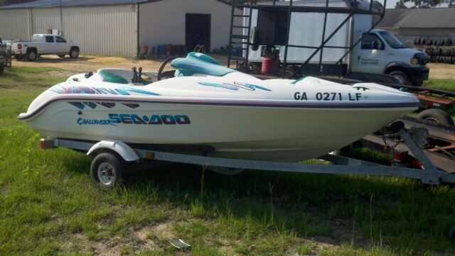

new here, new to boating, new to me old 97 challenger. Questions
SYKO
Ive been on some sort of motorized machine since little, raced flat track on atc's and atv's still race off road atv's and ride a triumph Daytona 955 every day....But now... I got a boat:facepalm: lol Ive been wanting to get my feet wet for years and have had my eyes set on any seadoo that was within reason for me to get. I deal was struck and Im picking up a 97 Challenger single engine model, Ill start with little more than $200 in the boat. Story goes PO lost the keys in 2000 and it sat ever since under a lean too!!! So the seats are shot, no biggie... but needs a key and Im guessing a big check list of things to check. Ive been reading a bunch on here and I have yet to understand some of the components in and on this boat so bare with me, if you tell me to check something.... its a good possibility that I wont have a clue as to what your talking about so help me out on that. I still have to pick the boat up as its not local, so I got a week ahead of me yet to make my checklist up, As a long time 2stroke rider/racer just to make my life easier Ill just do premix as Ive always got that around for my atvs. Any way Im really stoked about getting out on the water with this unit, I don't plan on making it this summer but next year im all in! so Ill have plenty of time to get it squared away. Plus I have a disabled daughter and were all in agreement that some water sports will be right up her alley:thumbsup:
comments, sugestions, opinions are all welcomed!!!

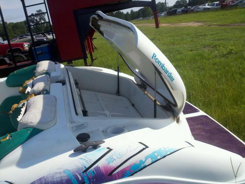

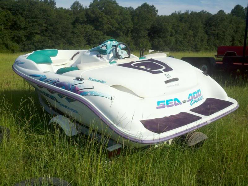

got some more pics as it sits now, ill be picking it up sunday

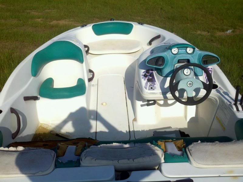

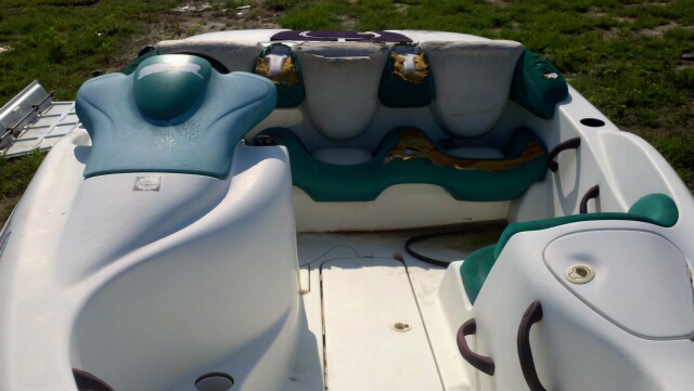

new pics up, upholstery is obvious... but you guys feel free to pick it over and tell me what you can see in the photos:)
How much$$ ????
I've seen worse. Heck... I've rebuilt worse.

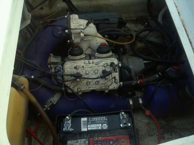

From the pics... I don't think that engine was ever apart. If it's not rusted... it may run. Once you get it... take out the sparkplugs, and remove the gray cover behind the engine... and turn the PTO (little flywheel) by hand. If it's smooth, and the sparkplugs aren't crushed... try to start it. (after you get fresh fluids in it)
The big thing is... it's complete. So, the rest is easy.
ACTUALLY.......
I JUST NOTICED SOMETHING......
In the picture showing the helm.... the start/stop button... and the lanyard post is missing. (Red flag)
Then, in the picture with the engine... there are some wires hanging..... those should be in the "Gray Box" that holds all the electronics. I can't see if that box is there.... but I'm going to guess someone swiped all the expensive electronics.
Ask the seller... POINT BLANK... Is the electronics box mounted on to the hull, just behind the rear seat??? And, are all the parts in it?
If it's not there.... then that needs to be a VERY cheap project.
Basically... that boat MPEM is no longer available. So... to get it running... you will need an entire gray box out of something like a 1996 XP, or GTX. It's not going to be 100% compatible... but you can wire it up, and make it work.

It looks like the MPEM cover is sitting on the floor below the steering wheel. Will be interested to hear whether the box is there or not.
Personally, if the MPEM is missing or known to be non-functional and I could get that boat for $200, I would likely do it and part it out.
I don't think I would want to take an engine of unknown history and condition and try to mate another MPEM or an MPEM alternative to it. If I knew it ran, and ran well, then the risk would be less. But not knowing anything about the condition of the engine, jet pump, or any other electronics... even at $200 that looks like too much risk for me.
