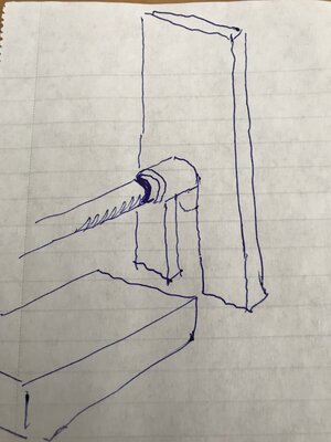

hopefully this photo makes sense. I cut a piece of wood with a U shape to perfectly fit over the "hat" and a second block to place between the engine and the bottom of that U shaped piece and pry. works really good.

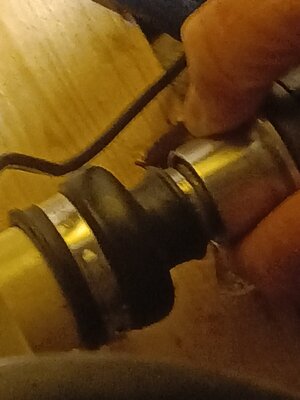

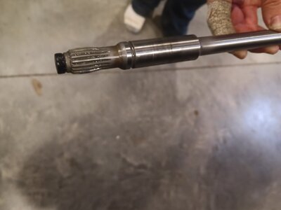

I feel a little stupid. My problem actually is the drive shaft went into the flywheel boot too far. I have both drive shaft bumpers on but the driver shaft will push into the boot all the way to where the c clip retaining slot is. Is the issue the driver shaft bumper is worn out? I reused the old ones. Or am I missing something else? Basically the drive shaft with the bumper on pushes to far into the flywheel. Where the c clip slot is now there is no way too keep pressure on the carbon ring.

Bumper looks ok.
The clip shouldn’t change anything at all since it sits in the exact spot as the 0-ring.
I have a feeling my issue is caused by a new anti rattle cone I installed. Once the pump is installed the carbon ring has zero pressure on it. The new cone is putting more pressure on the drive shaft than it had previously. I bought a new carbon ring set and if that doesn't work I will put the old cone back on.
