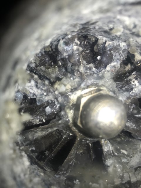

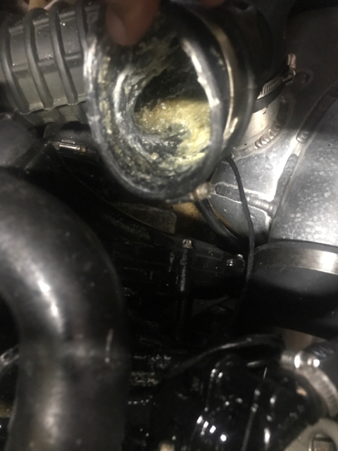

So I have come up with the super charger being bad. It was full of water. No clue how. So now I have to change that and figure out how water got in there.

I do not believe the motor has water in it. Pull plugs and no water. I am coming to the conclusion that the intercooler went bad.
Anyone's thoughts.
OEM has been updated. Know problem with 2012 type IC. Is it completely fixed? Not sure but probably not. Is it better? Yes Are there better aftermarket alternatives? Yes
Sorry, my point was, do not get a used one as you will likely have the same issue. I do believe the IC has been updated as well. So if you b a new one, you should be ok.
