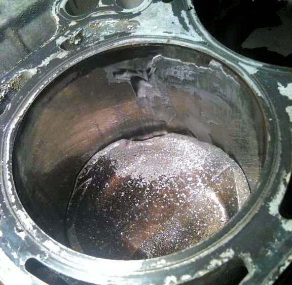

I have a 2003 gtx supercharged no compression in the middle cylinder. Removed head to find piston melted down the side throught the first ring land and starting into the second. the hole is located in the depression for the rear valve on the center cylinder and melted a hole into the cylinder wall. i know i need a new block but have no idea what caused the problem and fear it reoccuring this is the second rebuild unfortunely i did not do the first myself so i am unsure if this is the same problem reoccuring the first one cost 7000 not sure what to do now oh yeah had to replace computer on engine after last rebuild related unrelated who knows.
thanks in advance for input on this matter

that was one of my first thoughts when i saw the spark plug electrode melted clean off before i split the engine. is an injector fail common. i thinking of replacing them to eliminate them as the source of the lean out
injectors rarely fail that way. check your water pump and cooling system. the middle cylinder will overheat first due to heat build up on each side of it. what happened when it failed? all of a sudden? did it run bad for awhile? how about some pics? that will help diagnose as well.

lean out condition is more true with the 2 strokes than with the 4tec. injector problems are obvious problems and it won't run very well at all so heat typically doesn't have a chance to build up like the 2 strokes that run fantastic just before they let go from lean out.
However, overheat and leaking head gaskets that allow water intrusion will melt pistons in 4tecs. Does your piston look like this?

the pistonlooks perfect except in the bottom off the exhaust valva divit there is a hole half the size of a thumb nail through the top of piston and out the side under the rings and 1/32 of an inch into the cylinder wall. starting to wonder if there could be a small crack in the exhaust manifold allowing a drop off water to settle into the divit. Now that i have taken it apart myself the first guy would not of had to take the exhaust off the head at all justput the whole assembly on the short block . would probably b worth getting it scannned for hairline cracks. i dont know every thing looks good no obvious gasket failures
exhaust manifold leaks don't usually cause piston damage, exhaust gases will push the water out.
did they replace the head gasket? or use the old one? some bad shops think they can use the old one and won't spend the $80 on a new one.

I "ve seen the piston pictures. Kinda strange. I was thinking like ski-doo....... coolant in combustion chamber. The piston would be clean if that where the case. Give us a picture of the spark plug and cylinder head. :cheers:
unfortunatelty i changed the plugs last summer and cant find it now. i was so mad i just parked the seadoo till now. it looked wtite like super lean condition and the steel ground above the electrode melted right back to the threads. the head looks good no discoloration near the valves
