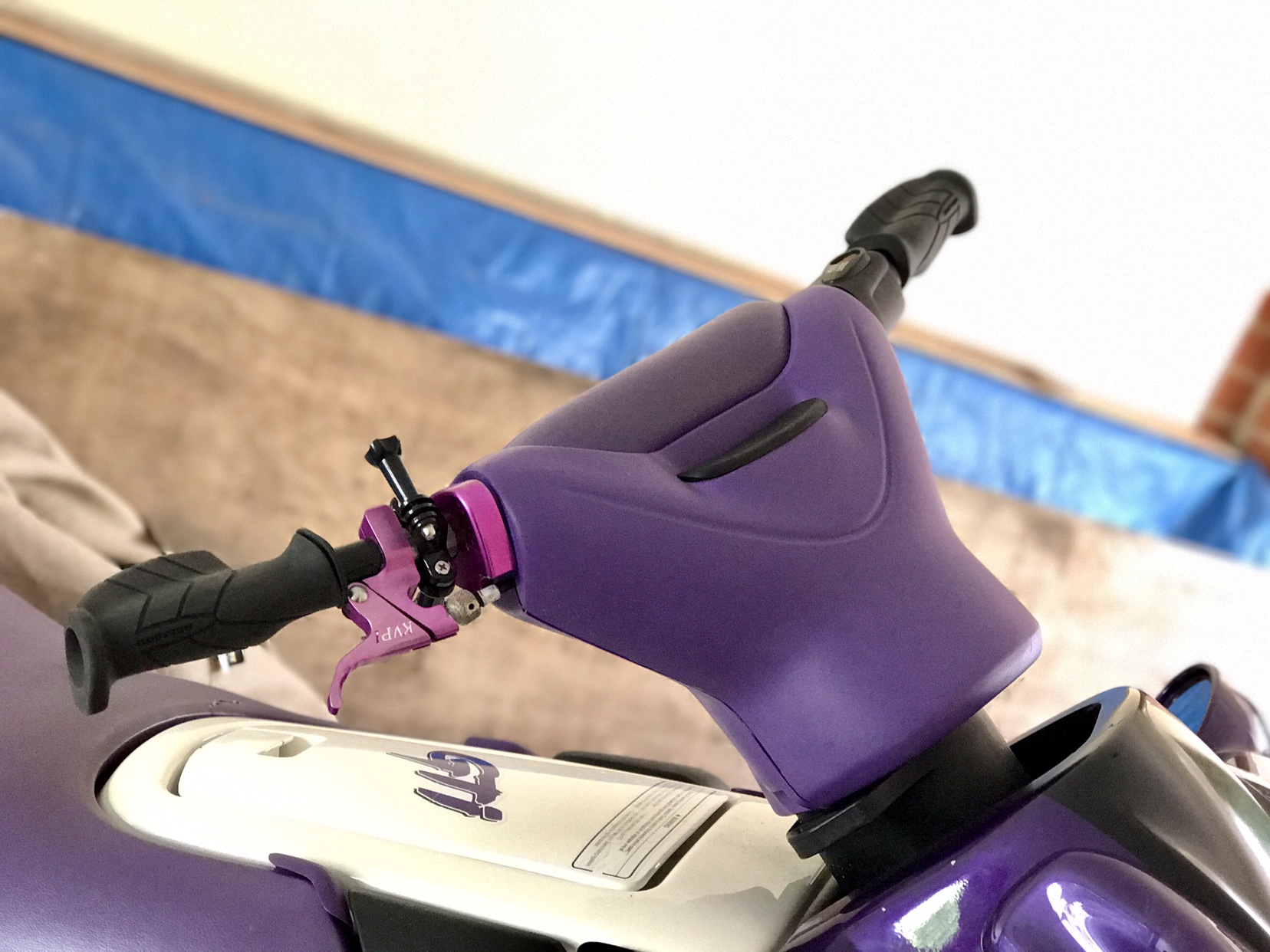

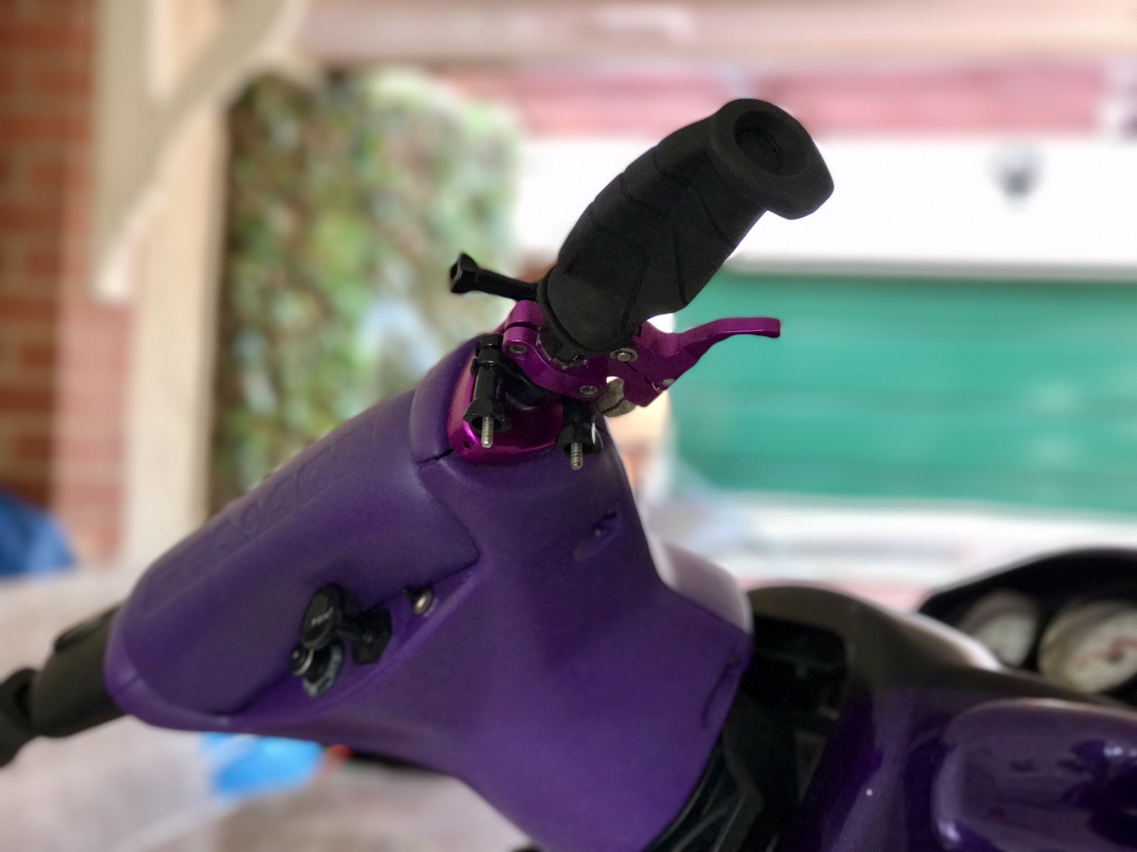

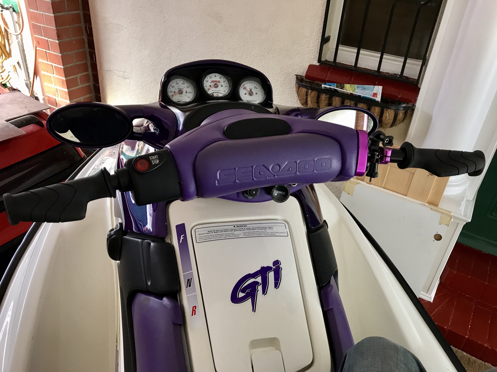

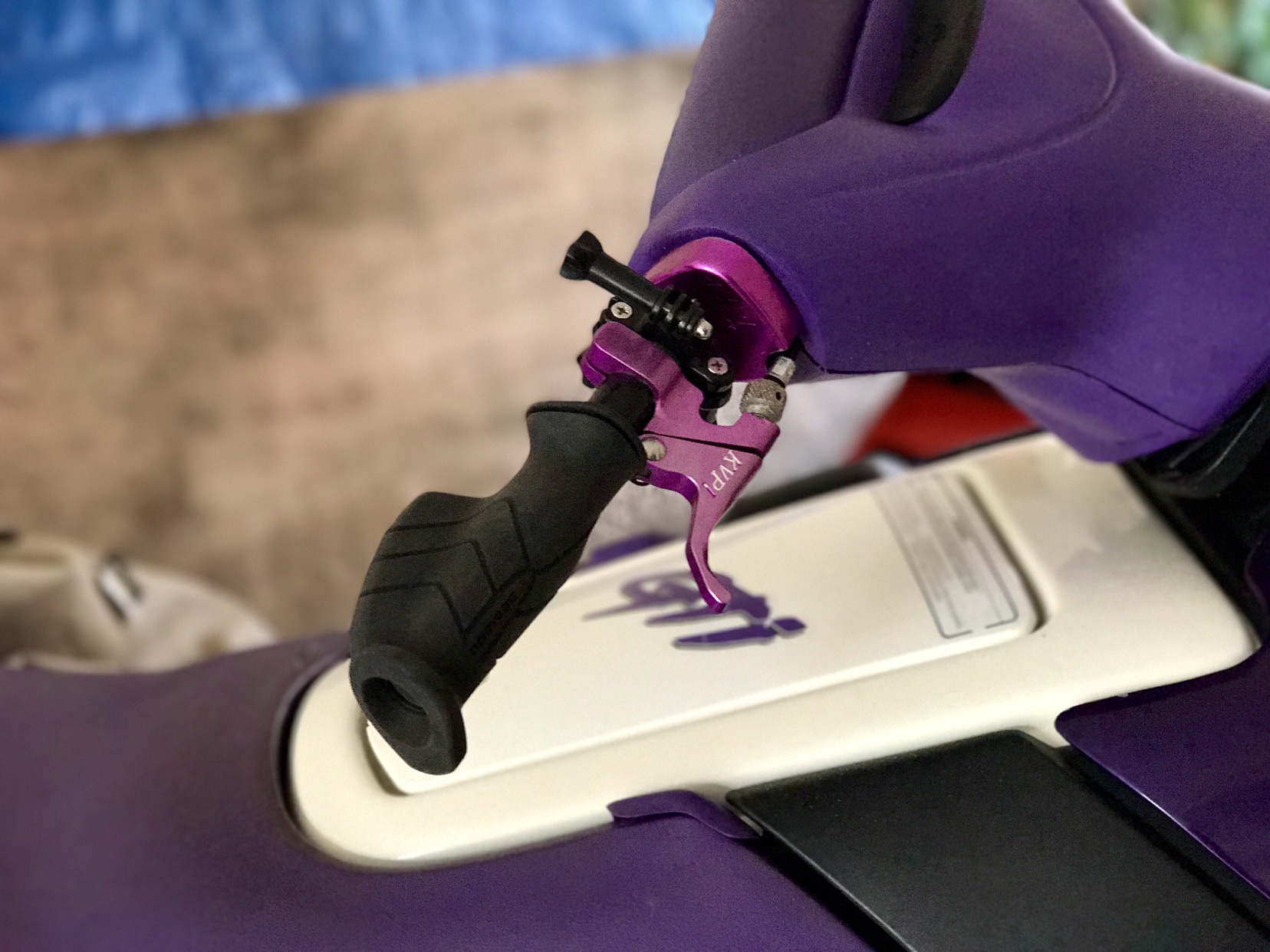

Just thought I'd post some pictures of my setup. I know a few people have asked if one or the other are possible. I'm really happy with the combo.
Only thing I needed to do was change to longer bolts for the palm grips. Stock are 40mm M6, which is a touch too short. I changed them out to 60mm M6 and they worked a treat.
