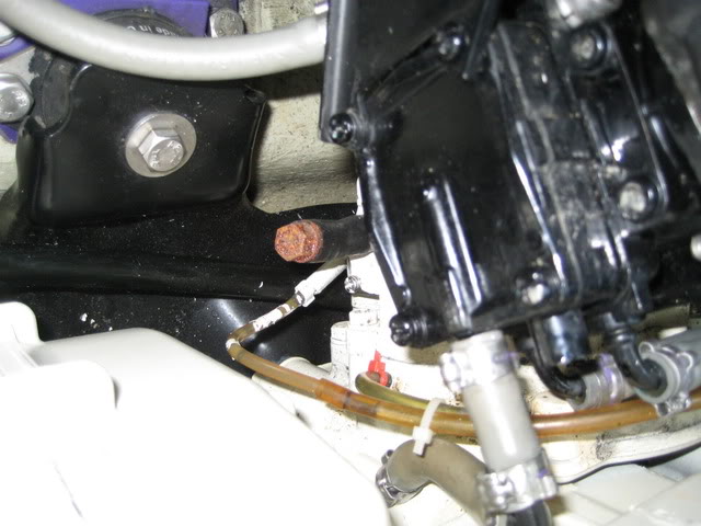

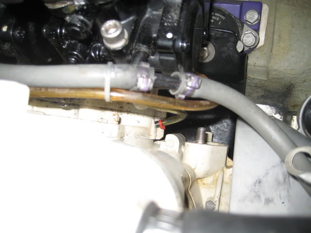

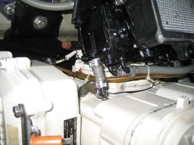

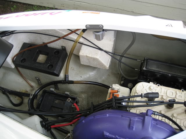

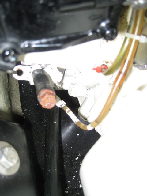

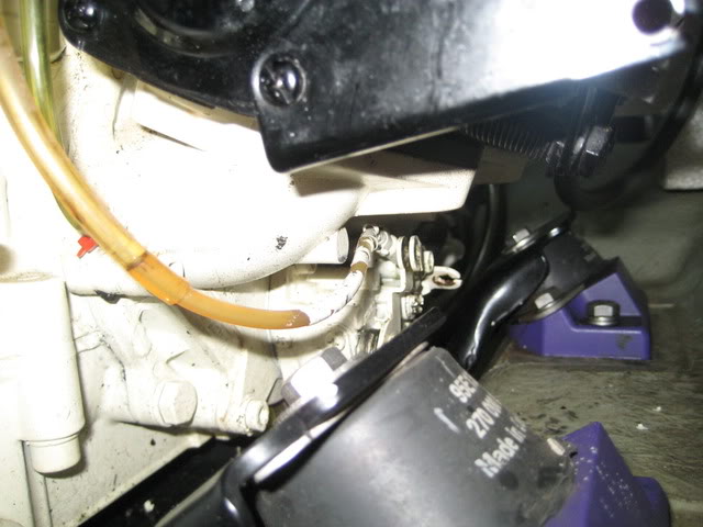

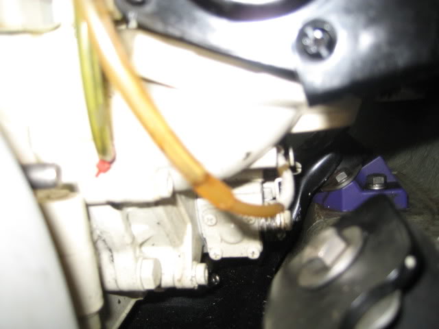

Pics...
Hopefully, these pics can help clarify...
Here is an overall showing no tank...
And here is the rest of the system:
I was standing on the port side of the ski when I took these. The first three pics show lines connected together from the front (to my left)
Once again. Standing on the port side. You can see how the lines are connected in-line. The last two pics were taken by putting the back of the camera against the fuel tank.
I'm pretty sure the pump is still on. Is that correct? It looks like the oil lines are looped. Is it possible to put in a small bottle (water bottle, etc) to take the place of the tank so i can ride the ski tomorrow?
I'd like to find the manual for the ski as well. I can't access the ones on this site yet, and seadoomanuals doesn't seem to have one for the hx.
If someone could take a look at the pics and tell me whether or not I have anything to worry about, I'd be grateful.

did you get oil to that rotary valve???? you can loop the line, or put a tank back in but it gots to have some oil.... it is located under the carbs, on the motor.... you di=ont wanna seize it up homie....and you may be a lil oil fouled from runnin rich.... i run 2 stroke race bikes...YZ250 @ 32:1 and they double RPM of a ski!!!
Thanks for the quick response dude, but how do I get oil to the valve if the lines are looped? Does it really use oil, or just circulate it? I've heard that it really doesn't use it, so that leads me to believe that the loop will be cool.
If I have to put in a tank, what can I use that is a good replacement? Can I use an old pressurized coolant tank out of a car or something similar? How would it hook up? This would be easier if I had a manual-lol.
Oh, I ran it with a 40:1 mixture. It seemed to run pretty well, but I have no point of reference, since it was my first time on the ski, and I'd never ridden an hx before.
It don't look like you have the oil injection pump lever cable there. The PO probly
removed it working on carbs and didn't know how the re-install on the Inj pump,
or wind the lever counter-clockwise a turn to re-latch the pump spring. Then just
shrugged his shoulders and threw oil in the gas, and maybe threw tank away. I
have a complete oil tank if ya want it. PM if interested $25 shipped. Bills86e

Loop is ok...
So from what I've read here heard from other members, the loop is an acceptable way to supply oil to the rotary valve. I just have to keep an eye on it and make sure there is always oil in the lines, and refill every 60 hrs or so, just to be safe. The valve only needs a few ounces to keep lubricated. I'm told that keeping the tank is preferred, but the loop will work in this case...since I don't have a tank. (thx. daverade)
