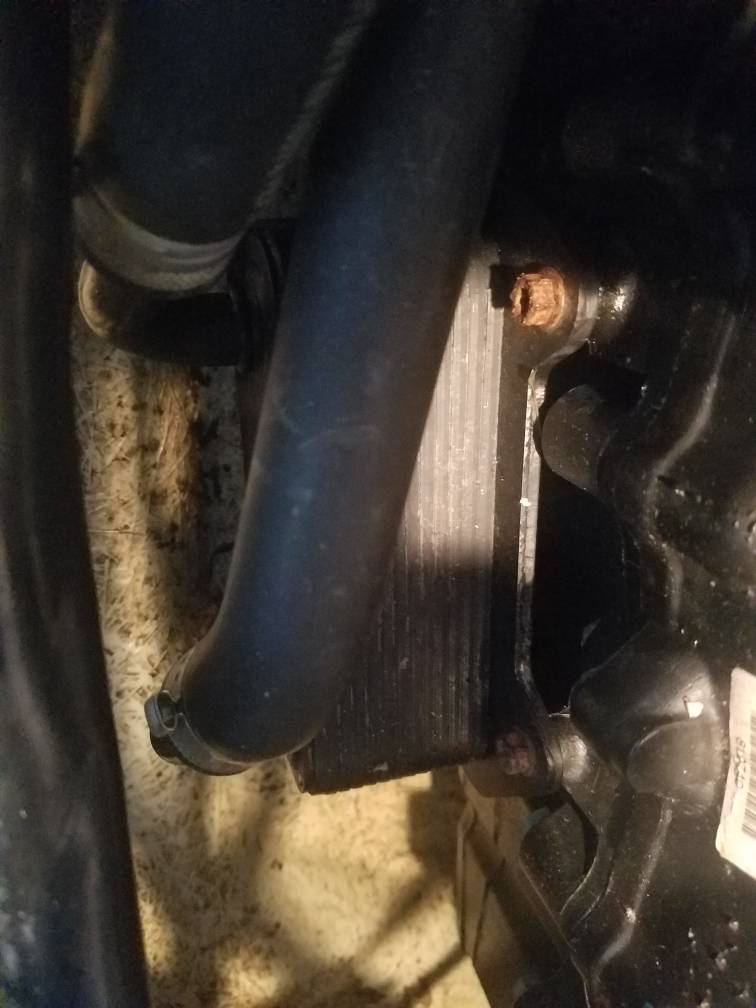

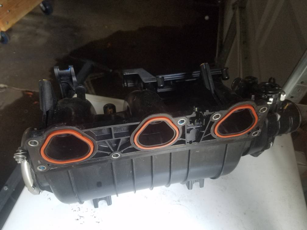

I believe I mentioned that I already purchased a new oil cooler. What I see as a big problem is getting at the oil cooler with the motor in the jet ski. Its at the bottom of the motor a extremely difficult to get out no matter if I run the test or just put the new one in. Any suggestions on getting to the oil cooler?????
Phil
you have to pull this part
It looks like you did it right. You don't actually have to pull the intake manifold out, you can just pivot it forward to get plenty of access room to the oil cooler. Now just take the 4 bolts out on the oil cooler but is better if you drain the oil first, even then you should put rags under it because it will leak quite a bit of oil.
