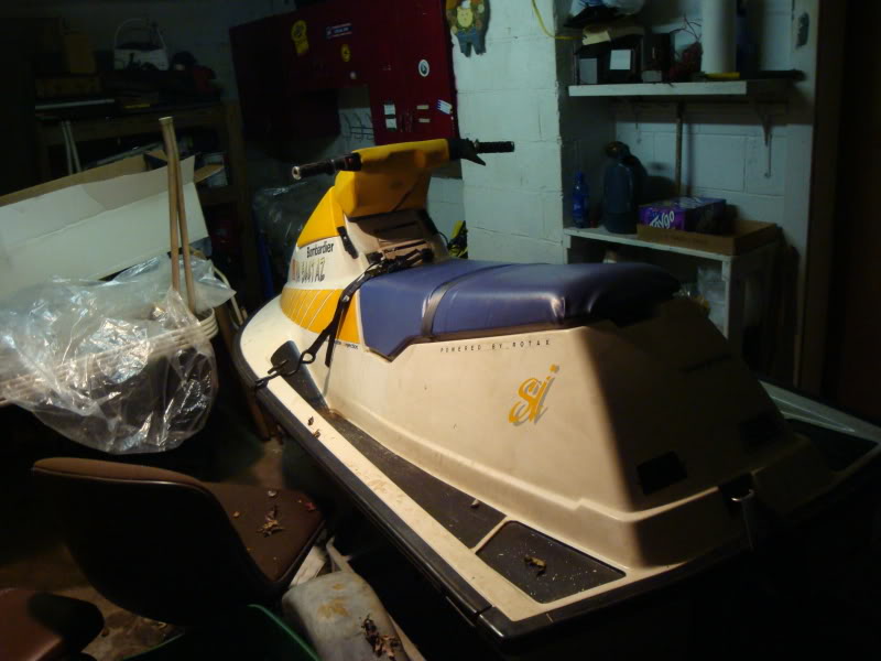

I have an ongoing resto/mod project on a 96xp and need to give props to LouDoo his advice has been right on the money. Wish LouDoo lived next door then this post would be in reference to the epic rides instead of working on skis. Now to the next question. I am buffing/restoring the hull and have tried course cut and fine cut 3m polishing compound but I'm not real happy with the results. Can anyone suggest a product that they have had good success with? Also after I get the oxidation removed what is the best polish for that new ski shine that the water will bead on?:cheers:

You are dealing with Gel coat. It's hard as a rock. Fine cut compound was meant for soft, thin paint. If you are trying to bring back a ski from years of neglect... you need 3m Super Duty compound, a rotary polisher (not a wimpy DA) and a big foam pad.
All the pics blow are just the compound. No wax has been put on.
Here's some before and after examples......
YUUUUP!!!! Ive buffed many boats and superduty is a good compound. Its aggressive so be warned you can take gel coat off fast.
If you are just looking for a good shine and have a white hull you can typically just use superduty. If you have another color such as black or are looking for that perfectly swirll free finish you need to go through a few more steps.

Thanks guys, I did not realize gel coat was so hard. Off to home depot and oriellys to get supplys for another hot night in the garage. On another note, is someone still manufacturing hydraulic trim systems for the older xp skis? These skis are so popular I really don't understand why the aftermarket guys stopped supporting them. Everytime quality performance parts get posted in the classifieds they get jumped on like ducks on a june bug...wth?
