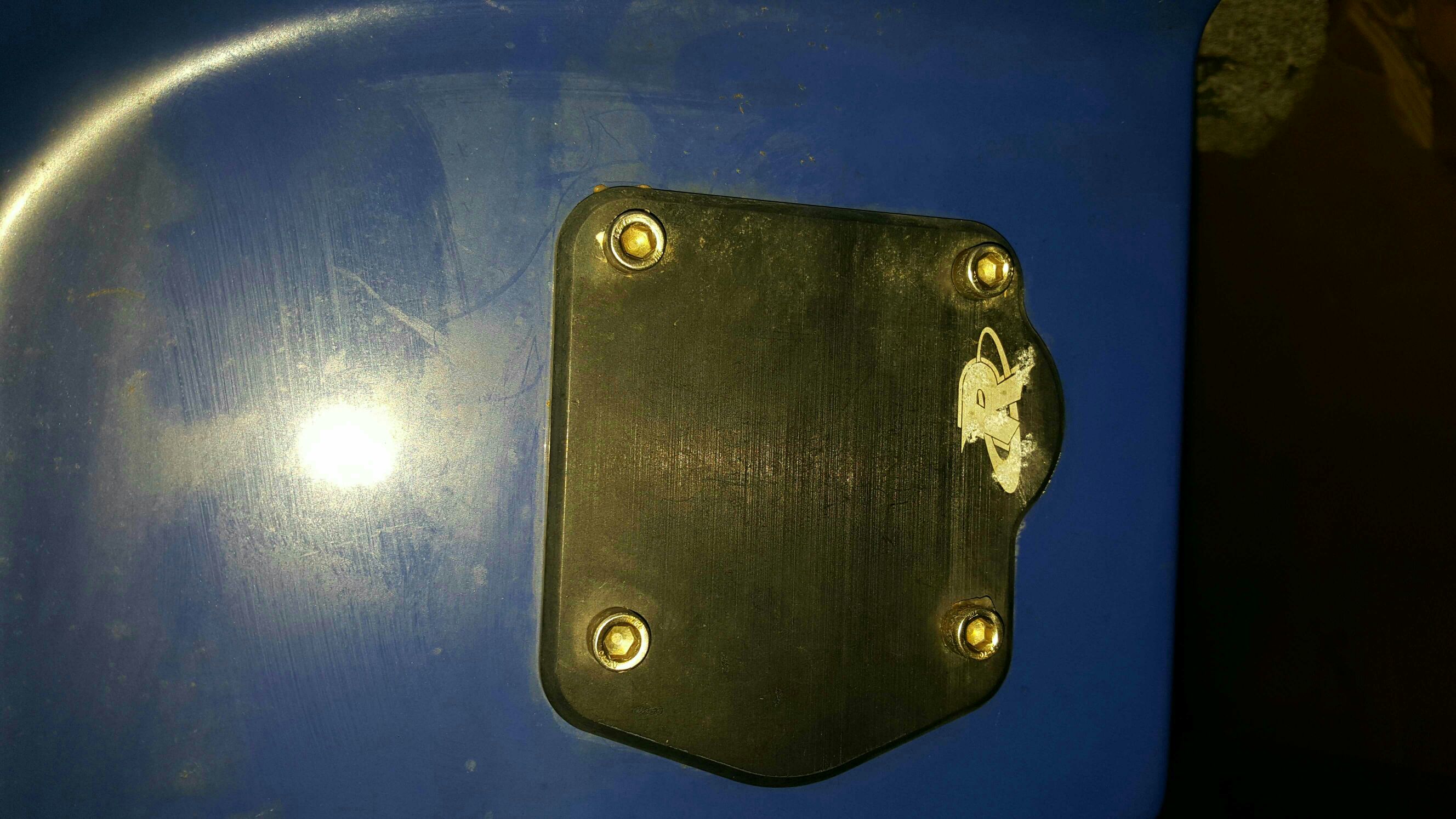

Sorry yes its the opas system. I need to get a new set up. The original broke off as well as the end of the shaft that controls them. Any recommendations for a replacement?
I had same issue. 1 tab got broken when at the dock. I bought a block off kit and bypassed the opas system. Makes the 3 seater turn like a 2 seater. Only issue is the off power stearing is gone which means you have to be more careful when trying to dock or if you release throttle there is no stearing. Stearing will only work while throttle is engaged. Took about an hour to get used to it but now i love it. Feels faster with no drag and turns faster now.
Either purchase block offs, or buy a used set from someone that took their set off.
Mine have been removed. And yes, it turns like crap around the dock. But I am used to it now.

Get rid of the O.P.A.S! Much more fun without them, and those parts are way too expensive!
