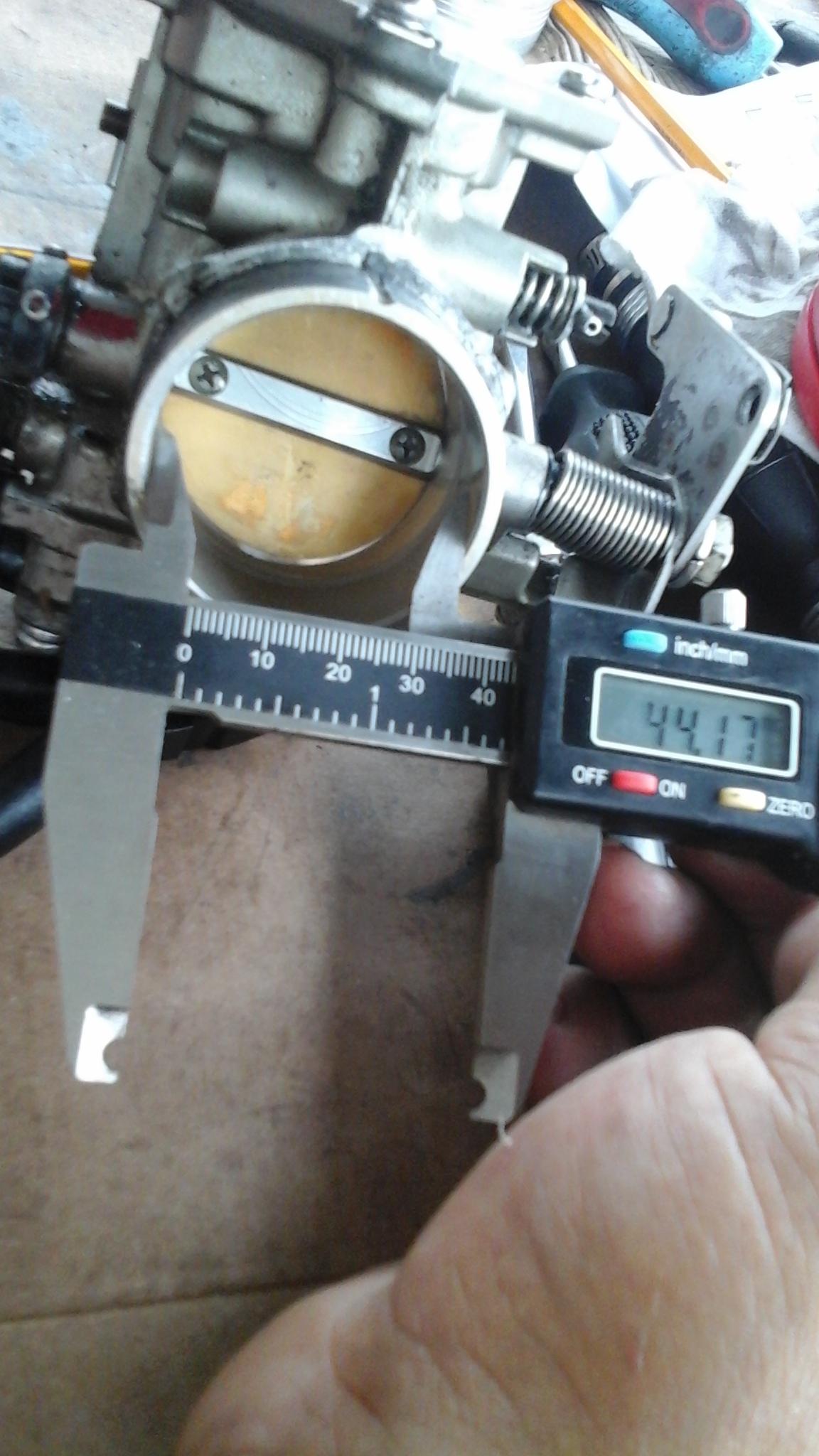

Nobody ????recently bought a 96 xp and I plan to buy the kit to rebuild carb.
but I do not know anything about these carb with 2 fuel pumps
someone knows something about them
The previous owner told me they were 44mm
thank

Those carbs are early Buckshot's. They work really good feeding modified engines that have aftermarket pipes and such. They may be a little much for a stock set up. Did it run well before? If so then it will again if you left the same springs in and it holds pop off psi. It will be down then to the turning of the adjustment screws.
If these carbs and manifold are the only aftermarket parts on the ski then I would put it back stock. That way you know where everything needs to be and it just works. If you want to tune it with those carbs I will be happy to walk you through it.
Run betterSounds like a well set up boat. 58 and a good idle is good. Now you know it has good jetting for the setup. That pop off sounds fine. Here is what I would do...
Start with the lows out 1 and 1/4 turn and the highs turned out the same. Turn out the mechanical idle screw just until the butterfly closes completely. Rotate the round bases in the spigot mounts until the two carbs open and close together. When you crank it on the trailer set the idle for 2800ish. Hit the throttle quickly and see if it bogs or loads up. If it bogs then turn out another 1/4 turn.
You will need a good digital tach to dial it in up top. You will need to ride it in a place with flat water where you can make some high speed passes. The last thing you want is to hear "spark knock" or to have your rpm's backing off of their initial highs. You want to have it pull hard all the way to top rpm and hold it. After checking max rpm open the highs 1/8 of turn and make another pass. If you gain rpm open 1/8 and try again. If they fall go back in in 1/8 turn at a time and watch the rpms climb until they don't anymore. Then open those highs 1/8 so your not too lean. You should pull your plugs after high speed runs to make sure they are not grey or white(search plug chop test). The rear cylinder tends to run hotter so leaving the high speed needle out 1/8 further is good practice.
