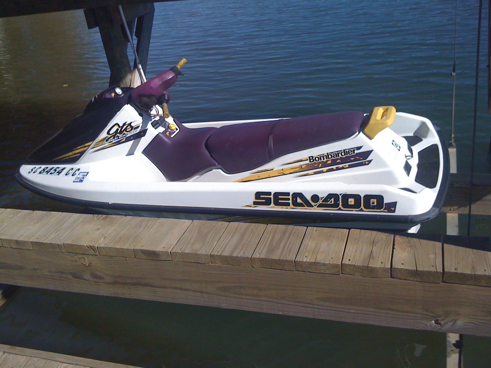

I have a 1998 Seadoo GTS Bombadier that I picked up last year. THis morning I went out and all was well for a bit. Then is started acting as if it was running out of gas. It would move along and then almost die. It did this several times until it finally stopped.
I have a full tank and it was recently serviced so am I doing something wrong?? Unfortunately I am not mechanically inclined at all...

PS: This is what I have:
