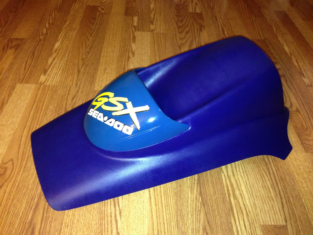

I did the heat gun treatment today to one I am selling. Worked out well. I removed the deflector and put it aside, then reattached it when I was done with the hood.
Nice job, looks great. When doing the heat gun, how big of an area did you heat at once? Did you do it in long lines or square box sections?
I try to do long lines at consistent speeds, very easy to heat it too much and have some irregular glossy patches. Depends how picky you want to be.

Shawn, looks like you were in the same "boat" as me. too bad they didn't make the shield out of the same plastic. Mine also faded
to a shade of blue.

Yeah it's a shame, the underside looks great. Decided that keeping the decal was better than screwing up a perfectly good deflector.
No that was my iPhone flash- color looks the same as the "before" pic.

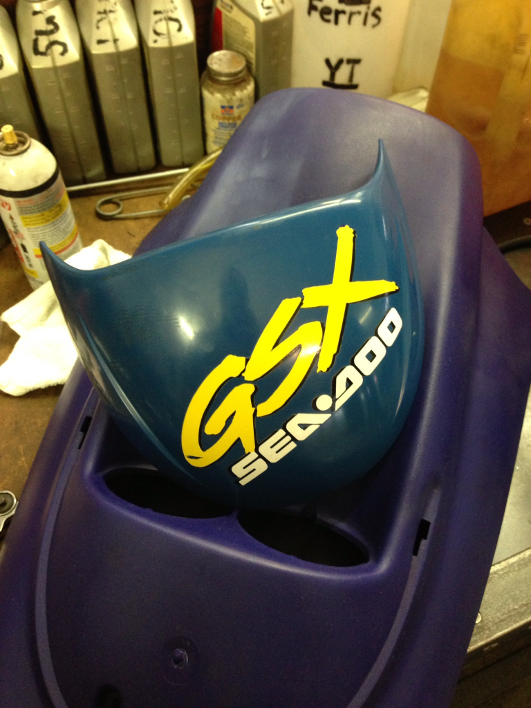

Took this during the resto yesterday-
When I peeled off the decal on my original unit in hopes to sand off the faded color, I knew it would be a difficult decal to replace. Not only did I scrap the decal, I learned that the faded pigments go so deep into the plastic, it can't be sanded out. So I destroyed mine both ways.
