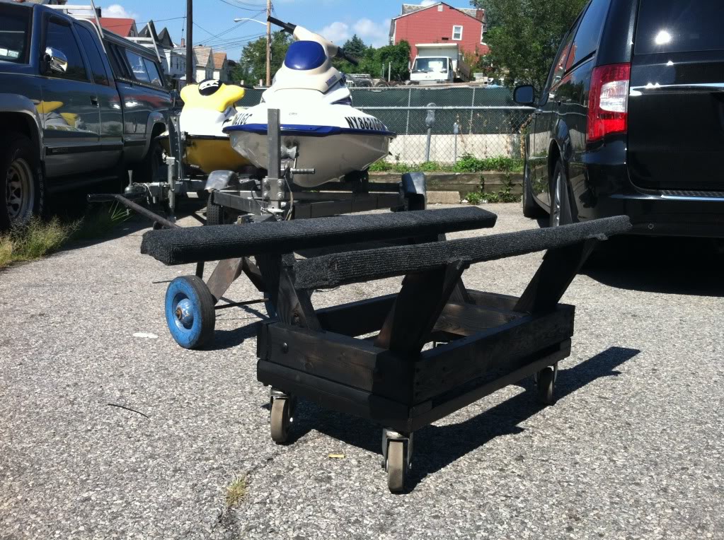

Well here's what I made and it works great! Same height as trailer of course!

I made my cart taller than my trailer. I'm 6'-2" and I don't like to be bent over all day wrenching on something. I used plans I found online on PWCtoday from some twinturbomustang user or something like that, I'll post the link later. It's actually really easy to slide the XP up onto the cart. It's the perfect height for me, but if your vertically challenged go for a shorter cart.
