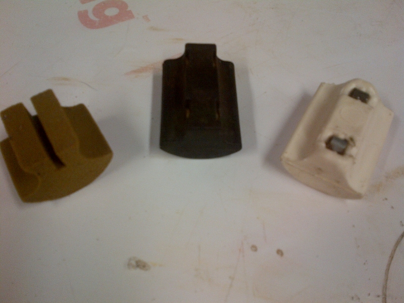

The same thing, its a little different style but same problem. The float you bought for your 96 will fit and work in the 95. the one on the left is what originally came in the 95
Great picture! I popped it apart & it has the gold porous one on the left. The magnet bailed & was stuck on the backside of the reed board. Did the gold one sink too? My 96 had the black one. It sunk like a rock & I replaced it with a white one.
The gold one came from the 95 XP, the black from the 96 GSX, and the white from the 97 GSX. All of them sank like stones. The gold one sank and the magnets were gone.

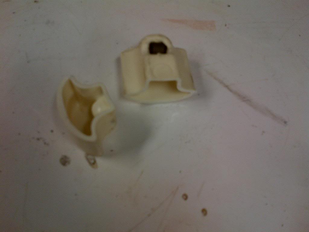

So, I ordered another seadoo replacement (white) float. If I remove one magnet, it functions fine in the 95 sender, however because the white float taller than the gold original one, it will never show completely full. Thinking about cutting it down to the same height, but I wonder if that would comprise its ability to "float" I cut an old black one I had in the shop, & its a solid piece. Not that it has to show all bars of fuel when full, but if I can make it work, that would be great.
Unfortunately you cant shorten it, the float is hollow and I dont think there is any kind of sealer that will last to reseal the float cause it is sitting in fuel all the time.
I did not take a magnet out for fear of creating a leak. My ohm readings are 87 at empty and 28 full. The spec is 89 and 17, so I will probably miss the top and bottom bar on my gauge when I install it.
