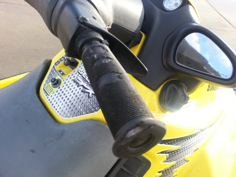

Thanks guys- That pix is just a mockup, not an implementation. I will have an adjuster and clean cable path. I guess you missed my point. I was testing to see if I could get full throttle. I am not looking to Ghetto it. But if there are other clean options, I will entertain them. Or just forget the entire thing. The point of this thread is an inexpensive finger throttle. I know you can do it for ~$90 (with all adapters) but I was looking for a clean lower cost solution. I actually really like the look of that Tekro throttle. Each his own. Anyway, not sure what I will do, but I will post it. And if I do it, it wont be ghetto or have mouse ears on it.

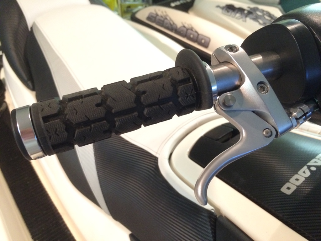

I get the low cost. You need the $13 adapter, you can't cleanly rig your way around it. That's why just about every aftermarket throttle lists a seadoo adapter. It's never "cheap" to upgrade. I just don't think this is one area to mess around in, especially with family involved if they're driving. The pic below is my ebay score, it was bought for $45.05 shipped off ebay back in 2013, it bolted on and I didn't have to tweak the cable at all. Like I keep saying don't be in a hurry and the good stuff will come to you, you also need to search for it every day.

No,unfortunately it was only about 3/4 throttle
I went back to stock on the GSX, after I tried to bend it and broke the cheap metal :)

I have the same finger throttle on my xp and I love it. The bicycle levers seem to miss the forward sweep on the lever that prevents full throttle from opening.
Part of the benefit of that GT manufacturing throttle is that the axis which the arm pivots on is on the opposite side of the handlebars increasing the amount the cable can be pulled out.
Most all finger throttles pivot points are on the front side.

Look at the bike lever, the perch is freakishly long this giving the lever more throw. Look at the ski triggers, they're angled even though the fulcrum off on the front side, they need that angle and also a swept lever to get the swing so it doesn't burry into the grip. But not having the barrel adjuster is killing your slack length. What I like about the GT is that I can run it with one or two fingers and the back of my palm is on the back side of the bars. With the bike lever off have to guess that your hand is maybe a little closer to the top of the bars due to the length of the perch and the angle of the lever. It all just seems very far off the bar.
Yep yep, the perch on the bike lever allows the full movement of travel to get WOT and down back to idle. But yeah you will be stressing hand. trying to get fingers to reach it out.

No worries Racer :cheers: That is what these forums are about! I did a sh!tty job explaining myself originally. Bottom line is that these require about 1.15" of pull which wont be found in a bike type lever system. At least not in a system that you can reach with your fingers. So it requires a PWC (seadoo perhaps) specific throttle. Therefore- more money. I am getting the adapter and see if I can get it to squeak out what I need. It will be close.

Well I finally got the blosion adapter. It is much better but I still am not quite getting full throttle. I still have my rogue grips on. It is close but not quite full open. Need another 1/8" or so. But I am going to lake test it to see if that really knocks anything off the top end. Looks good though. I cut my own cover end cap out of delrin. Pia.
Ok I tested the setup shown above. It is not quite getting full throttle. Speed was right at 50MPH gps. I really like it though. I found another one on ebay that is a billet aluminum one. It came for $50 with the adapter. (he now is charging $8 extra with adapter). So I put this on my other GTX. I fits great and I am only about 1/8" from full throttle. I may adjust the cable a little more and increase the water idle to 1600 rpm and I think I will get full throttle. I am using the ruffian grips on this ski (they feel really nice) and they are smaller diameter than the Rogue grips on the other ski.
