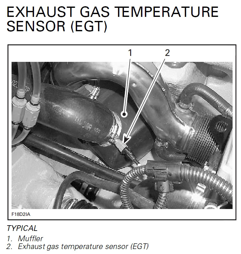

yes, that's a common problem, it's the blue sensor in the neck of the muffler(water box). the sensors are known for going bad and they are easy to test in hot water. but also the 3 small holes in the bottom of the j-pipe also can become clogged and restrict the flow to the muffler which will also trigger the h-temp exhaust alarm. the code is lost as soon as the temp comes down because it is no longer current, if you press set 5 times while it is going off it will give you the code or in BUDS it will show up as an occurred fault.

The temp sensor (EGT) just changes the resistance at different temp levels. At room temp, it should be around 2500 ohms. you can put it in hot water to measure the resistance output. At boiling, 212 F, the resistance is around 160 ohms, and this is where the alarm is triggered.
Or, you can just change it since they are inexpensive.
The J-Pipe is connected to your exhaust manifold. To remove, unbolt the large clamp from your exhaust man and loosen the hose clamps on the exit side as well as the small hoses that connect to the exh man. slide it back as a unit with the mufflerto get it off the exh man, then pull out from muffler side. you'll see the 3 small holes on the muffler side that tend to clog up. you can clear these with water or compressed air.

What generation Riva intercooler is on your ski, Gen 1 (vortech) or Gen 2 (same as OEM X)? The Gen 1 Riva intercooler is notorious for clogging or leaking prematurely. Check that no hoses are kinked throughout the intercooler & exhaust circuit. As the other poster mentioned, you should check the small holes near the tip of the j-pipe. It's common to drill them out slightly larger for more flow. Loosen the coupler between the j-pipe and waterbox and slide it up to see the holes around the lower rim of the j-pipe.

I wanted to clear 1 thing up quick...The sensor is not an EGT sensor, as the 4-tec engine doesn't come equipped with one. It measures water temp as you referred to afterwards.
SeaDoo does refer to it as a EGT sensor though.
That's quite unfortunate since they are only contributing to misinformation. Sure, there's gases in there, but there's a lot of water too!
When tuning the high HP (300+) 4-tecs with 14-38+ psi boost we put actual EGT sensors in the exhaust manifold to get true readings, which are in the 1600 deg. range, not 200 deg. like the waterbox sensor.
