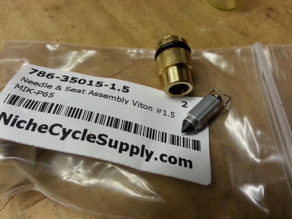

Are you talking about the Viton tips? If so I'll post a pic in a few hours, got them sitting on my bench for my XP
Here you go Genuine Mikuni Viton tip. Just got these the other day, unless they bagged them wrong this is what they should look like. Look just like the ones I put in my XP which were from atlanticjetsports.com, which I asked numerous times for genuine mikuni and got WSM or some aftermarket and they were NOT viton. Thankfully they worked and I've had no issues. You can see where I bought them, they were $20 a pop, but their jets are genuine Mik as well and they are like $3.95 a jet but the full rebuild kit was $50.95 ea. So I did the math and after I paid to have kits shipped for as low as $42 per kit the shipping put them close to $50 a kit. This place was a one stop shop and they shipped the same day, I bought from their Ebay store and if they don't have what you're looking for they will list it if it's in stock.
Those are the Viton Tipped 35015 but there is a new one out that is ethanol resistant and is number 35018. Amazon has the BN-38/44 kits for $47.95 shipped and the BN-46i kits for $37.23 shipped. They have the standard viton 35015 needle and seats for $16.38 shipped but I can only find the new 35018 in a 1.2 and it is $14.78 shipped.
