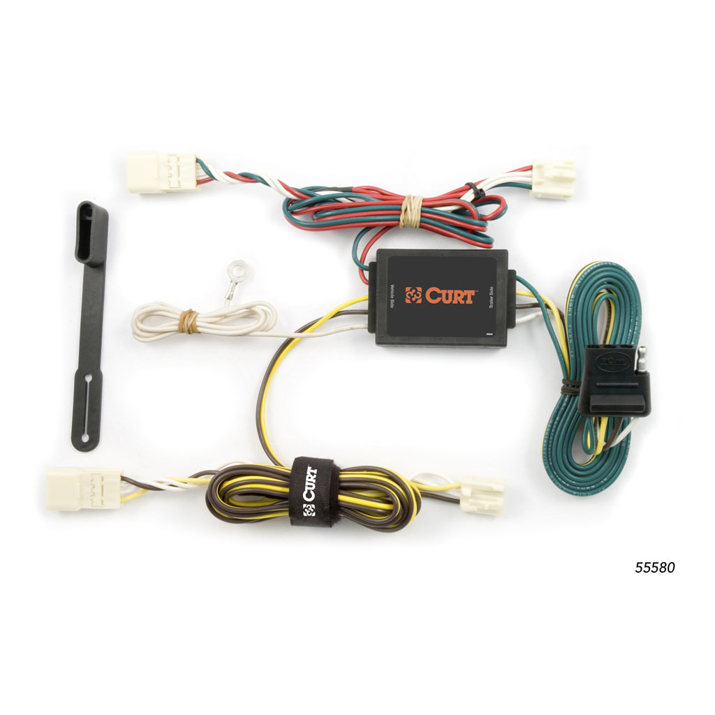

Four wires setup is.
Green Right Turn
Yellow Left Turn
Brown Tail Lights
White is ground.
Having a three-wire setup means (I am assuming based on common sense) that you have a LEFT turn wire, a RIGHT turn wire, and a TAIL LIGHT wire. Which means you are picking the ground up from the trailer.
So,,, I am betting your old lights had a wire or somehow were grounded to the trailer.
Thus,, you will have to take the white wires from the LED lights to the trailer (White=Ground).
Now you will have to do a little guess or testing. Use a DVOM or a test light to confirm which is the left and right turn and then you can follow the wire specs I posted.
Or,,, look at the back of the trailer, I believe you will find two wires on each side near where the lights mount and or, one side will have three wires and the other side will have two wires. If you have the 3/2 setup, look at the color of the wire that is on both sides. This will be the tail lamps wire. Hook your TAIL LAMPS wire to BROWN.
This will leave one wire on each side not used. This unused wire will be the turn wire for the side. Hook your wire to the GREEN WIRE on the right tail lamp as this will be your right turn wire. Thus,,,, hook your left turn wire to the YELLOW wire on the tail lamp on the left side of the trailer.

If it were me, I'd buy a 4-wire harness and use it. MUCH better quality connection.
