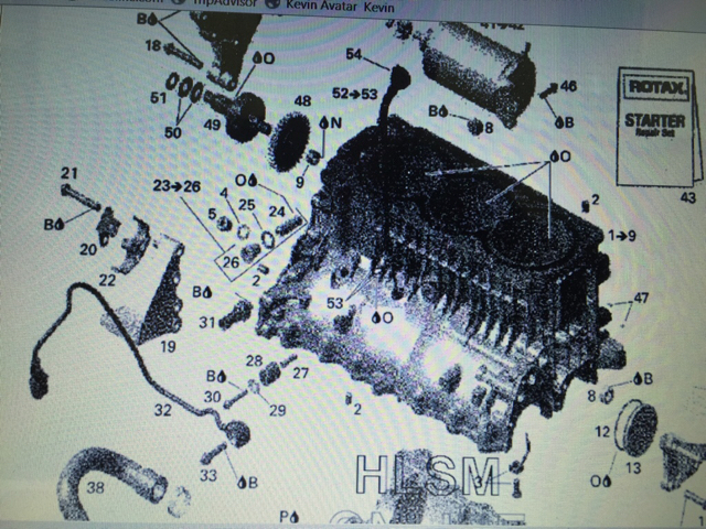

The code comes back as "OUT OF RANGE". That is normally an indication that the sensor itself is good and something around it is causing the issue.
You will want to check all connections very well. I have read that the following can be an issue, It's the mounting point where the sensor meets the engine block.clean the mating surface, remount sensor and do a test ride..
