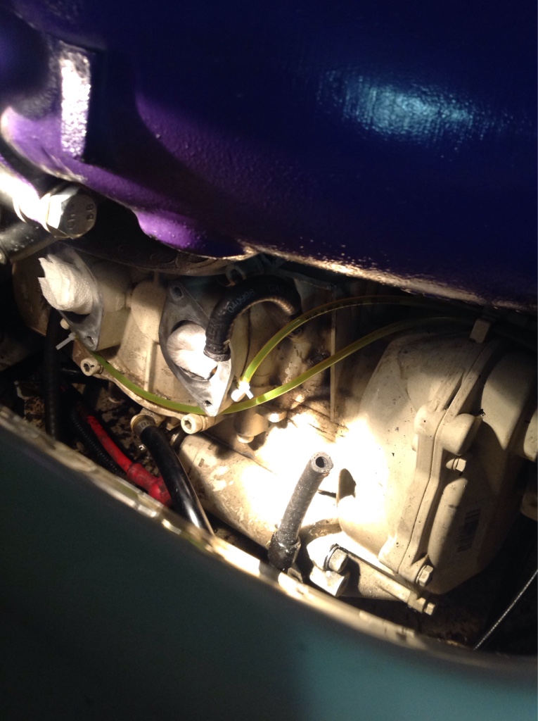

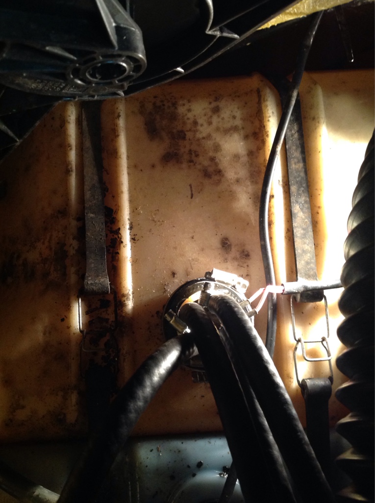

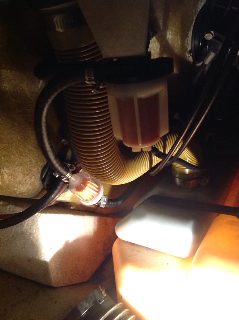

Ok a little update of my project here, I took out all the grey fuel lines and replaced the with fresh 1/4 inner diameter fuel line and replaced the fuel selector. The guy who owned it before me completely bypassed the fuel water separator and put an inline fuel filter instead. I ended up replacing the filter and o-ring on the fuel separator and hooking it back up and replacing the inline fuel filter with a brand new one. Can never have to much filtration. Since I had the carbs off I decided to check the internal filters. The previous owner stated he just had the carbs rebuilt so the gaskets were all still brand new. Once I opened them up the mag carb had slight garbage in the filter so I cleaned it out with warm water and soap. The pto carb filter was clean, so I placed it back in. I went to the local harbor freight and bought the necessary tools to perform a pop off test on both carbs. The mag carb popped off at 30psi so good to go there. The pto carb initially popped off at 50 psi so I broke it down and did some deep carb cleaning placed all back together and had a pop off pressure of 43 with a holding pressure of 35psi so good to go there. My carbs called for pop off pressures of 23-43 in case someone could use those numbers. After all that I replaced the 3/32 oil injection lines with brand new tygon lines. I read all these ways to bleed them but figured the easiest route for me would be to take off the oil pump and place my drill on the shaft and run my drill in reverse while holding the valve wide open. It not only lets me know if my pump is functional but it also bleeds the lines. Replaced the lines. Took apart my RAVE Valves actually not to dirty but deep cleaned them anyways and replaced the gaskets and placed back in the motor.
Here's a list of what was used
25ft roll of 1/4 Fuel line
3ft of tygon oil injection line
New fuel/water separator filter and o-ring
New inline fuel filter placed 10 inches past fuel separator
New fuel selector
20 hose clamps
