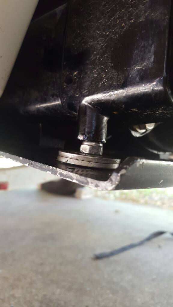

Putting on my ride plate today (thanks Aquaman1)two phillip head screws on the ride plate are become a pain to remove . They will not budge any suggestions. Anything special that needs to be done here?
You need to back off the jamb nut. Then use a HUGE Phillips screw driver to loosen the screw. You have to do it in steps. Back off jamb nut, unscrew, back off jamb nut, unscrew.
I have never seen the jamb nut down tight against the washers and tight against the top like that before.
Was it like that when you started?
Try holding the jamb nut with a wrench at the same time you are loosening with the screw driver.
Usually the ride plate is adjusted down and/or away from the jet housing to help with porpoising. On our challenger we had it adjusted down almost all of the way yet still leaving enough screw thread to keep it from ripping out. We also had it pitched down further on the drivers side because my husband weighs more than I do and this leveled the boat out during cruising.
With yours adjusted the way it was no wonder you were experiencing problems.
The screw is used to adjust the ride plate height, the jamb nut tightens down on the washers to "lock" it in place. (Leaving some screw visually exposed above the jamb nut)
I had a real time getting those screws out. I would blowtorch the black housing until it was red-hot, and then try and turning the screws out, but I just kept stripping them until only a circle-bit would fit them.
Eventually, I ended up using a flat-head screwdriver in the corner of the stipped part of the screw, and using a hammer to tap it - turning the screw 1/32 at a time. Then, eventually the screw was out enough to grab it with some vice grips.
