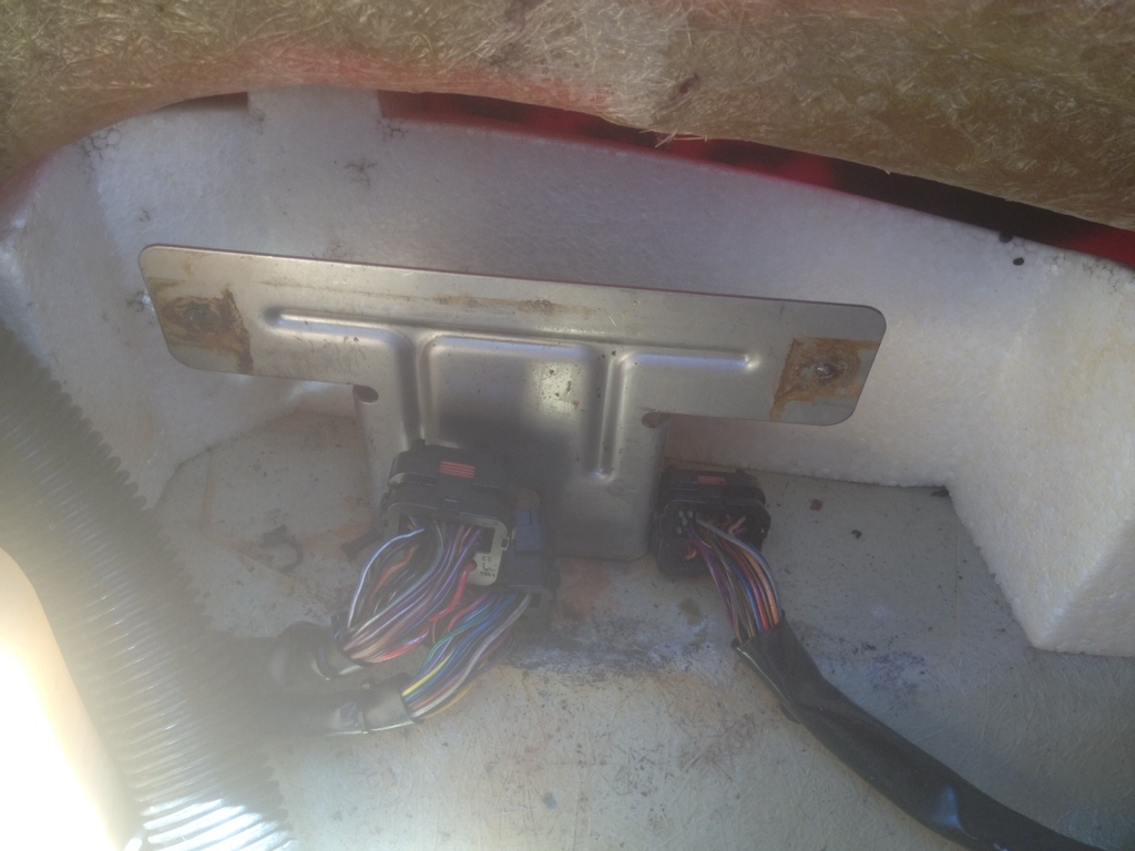

3 plugs means its a carbed model, The RFI has 4 plugs.
There are two different mpem's that I know of that take 3 plugs like that. Either the pre 99 version that doesn't have a throttle position sensor and the 99+ that does have it. Both look the same though. Same plugs in the same place.
While your waiting, Assume there was something wrong that caused the PO to have thrown out the old mpem.
Its worthwile to check the wiring and perform some end to end continuity checks on the harness. There could be something that will cause there next one to blow.
