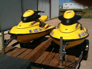

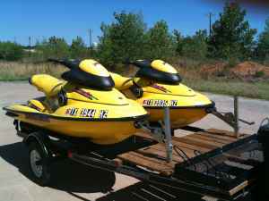

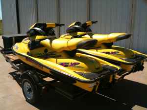

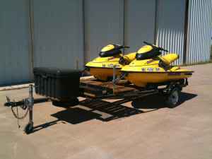

Here are the pictures not sure whats up with the add worked for me
But eveything has clean tittles he will be coming with me to swap them over they are registered untill 2012
comes with 4 life vests, 2 covers, 2 anchors (Well they are bags to put rocks in Lol) the tool box ect. Trailer has a built in bike rack
Really nice looking setup and clean skis! You may want to invest in a premium membership and download tbe user manuals and repair manuals. They will help tremendously in the future when things break or performance drops. Might save you lots of money in labor charges too.

Yeah i thought so too! have all the little stuff with them too tool kit fire extinguisher and everything.. They have some scuff marks but not worried about that at all.. They were a bit higher then i was looking to spend (My budget was 3k And i was looking at ski's that i would have to work on to get them going..) But its well worth 3800 for me to get some in this good of shape and i like the looks of the 97+ Way more anyways And the trailer was a big + Too its super nice.. I may end up investing in that in the up coming weeks will see how everything works out at the lake first :cheers:
