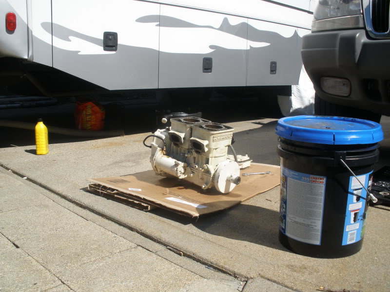

Today was almost 70º here in RI which after 4days of 40º and flooding rains was a nice break! so I got a full day to rip the block apart today... Oh boy is all I can say.. let me upload the pictures check back in a few minutes!
So I got started today.. I can definetly see now that I got BSed big time by the last owner.. This engine was NEVER rebuilt, The reason I assume this is because of the fact that all the bolts I removed on the starter, oil pump/rotarty valve case etc. were all still paint sealed/covered.. Unless the block was re-painted sometime in it's life, this thing was never taken apart (aside from the head, will explain how Ii know this later on in the pics)..
So I can also notice another thing, The old owner told me this was a "freshwater ski it's whole life, with salterwater use once or twice" When I removed the rotory valve case, a handfull of beach sand came out.. when I opened up the head, there was more sand than most RI beaches.. So what my assumption is, someone ran this in shallow water, sucked up a crapload of sand and never flushed the engine after use... took it out some more, untill the sand finally siezed the engine up.. I don't know if this IS what happened, but i'm sure it's a contributing factor :(
Pictures below... they are big so sorry if anyone has a slow connection. I broke out the dig camera rather than the phone camera, wanted you guys to really see whats going on here!

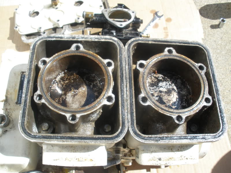

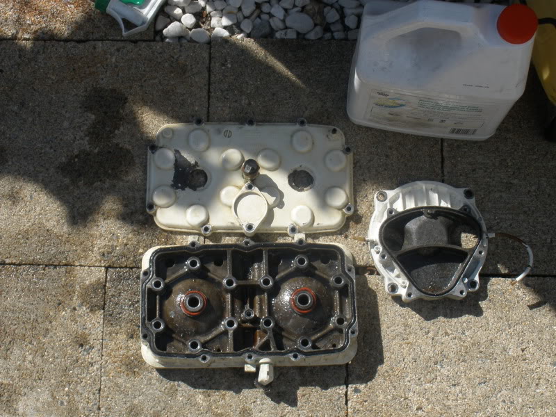

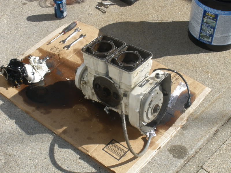

When I started, took the head off.. some sand, but so far so good...

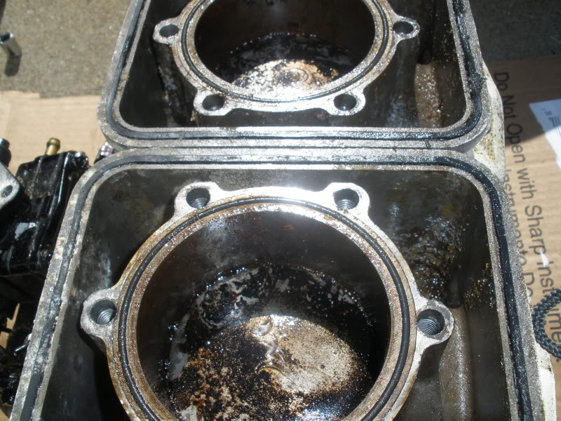

So after this, I inspect the pistons... Here, you can see some small marks in the top of the piston that (to me) look like someone tried to beat on the pistons to un-seize them, probably making it worse... it's not too bad it looks like they started doing it and then realized how unsmart they were being, after damaging the surface of the piston..
and yea theres some nasty sludge in there, another sign that they never took care of this poor engine.. seeing this neglect makes me want to save the engine even more.

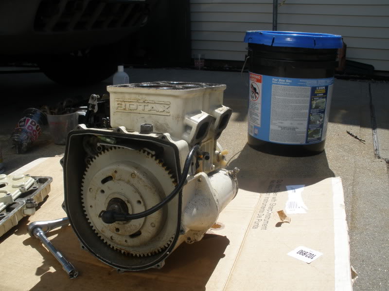

So here's some more laughs for you guys haha...

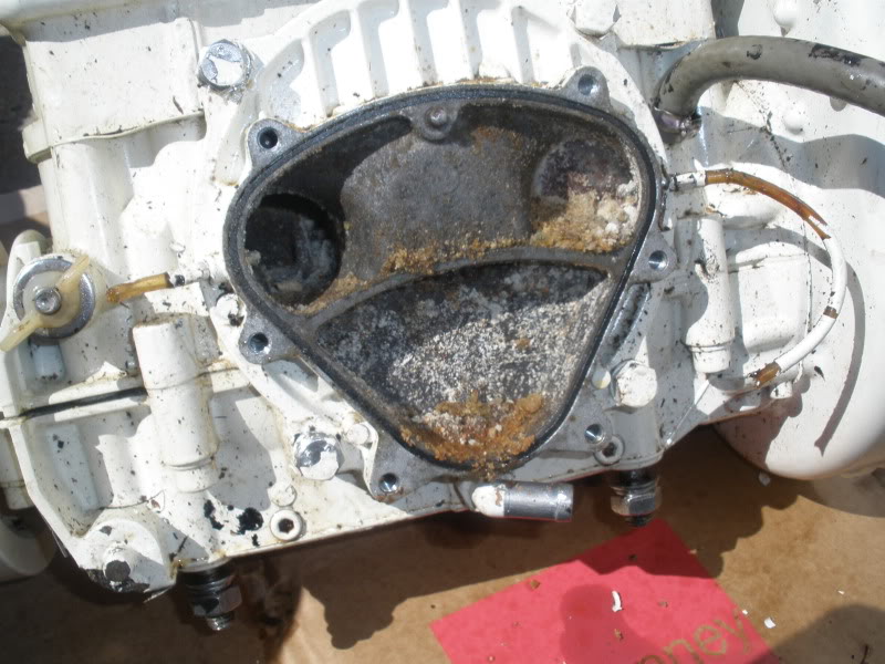

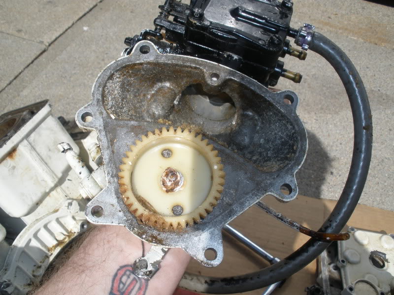

I take off the carb/oil pump/rotary valve assembly... Looks like they were collecting sand? :rofl:

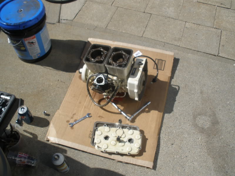

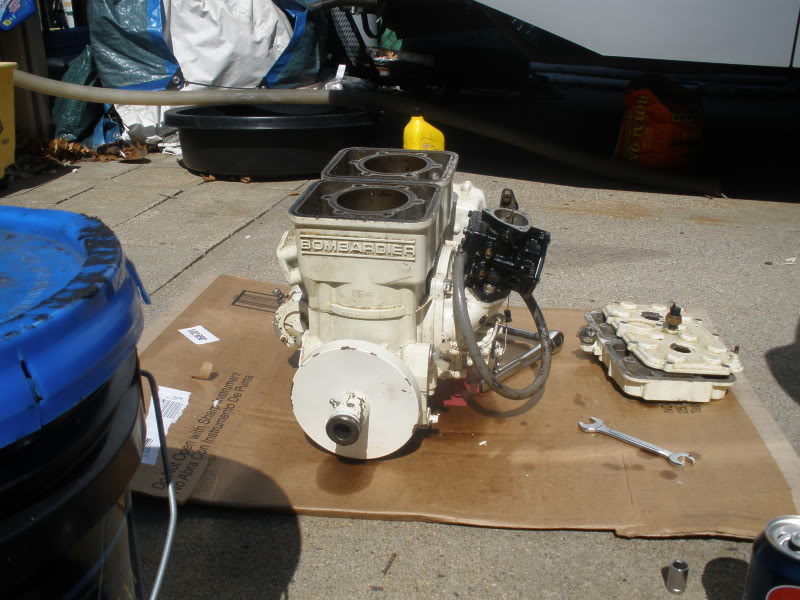

I tried to take off the cylinders, I took off the 4 bolts on the sides of the piston, but it didnt want to budge, I was going to wack it with a rubber mallet but I was thinking it would probably do more harm than good as the piston is stuck anyways....So instead I used a 150psi large capacity tank compressor and blasted out as much sand as I could... my garage floor looks like a beach now! I'm sure theres much more in the crankcase..
I air blasted the carb,pump & head, gave them a quick water rinse, soaked them in WD-40+PB Blaster and set them out to dry..
As for the engine, I mixed up some tranny fluid and acetone 50/50mix (mixed up qt of tranny fluid, with a qt of acetone) clogged up anywhere it could leak out and poured it on the pistons... it's outside soaking, I tried to pour some in the engine crankcase via the rotorvalve holes but it kept pouring out... is there a bolt i can remove that i can fill the crankcase with this mixture?
Thats about where i'm at now, going to let the engine soak overnight, maybe with a little luck it will free up the piston.. but i'm sure theres a pount of sand in the crankcase anyways so I guess i'll probably split the case tomorrow, any suggestions? should I split the case myself and Can I split the case with the pistons stuck?

I think your internal (crank/pistons) sand and corrosion has nothing to do with salt water use. Thats mostle from sitting. Or possibly it was sunk the last time it was ran then sat and rusted for a while. My freshwater machines have some corrosion in the water jackets as well!
The sand really could have come from fresh water beaching and lack of flushing, but you have been fleeced about responsible ownership - inspect the outboard peices because a SBT motor is in your near future - it looks like your sliding parts have been neglected and the rotating parts below the piston deck will surely look as bad from lack of winterizing oil coatings. Make sure the pump itself has oil in the cone, it was designed to be submerged in water and may be fine - the single carb is not a bad thing even if it did come with duel carbs, the single will be easier for a beginner to take care of and the lack of speed is just a few, you are a long way from getting in the water from these pictures - do you have a freind with this version ski you could swap the electrical box and see if it works before you invest 1000 to find this out? The mechanical stuff is easy to fix with money but the obsolete electronics will make an anchor out of the best prepared repair job.
