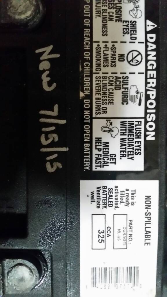

So, I was able to move the back half of the battery holder into the bow compartment and place the battery into that half first. Then I put the front half over the battery and had just enough space and leverage to squeeze the two halves together. I also used a clamp. The kind with a squeeze handle and could squeeze it together. When I released the pressure, however, the halves separated by maybe half an inch.
Next, I will use a small C Clamp on both sides to squeeze it back into position and thread the hold-down bolt back through the holes and into the base. There are some holes that line up on the sides, I may put a nut-bolt through those instead. There were none there.
