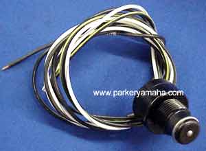

is this right?
it would be if your post is the one that has the little button you can push down and then it'll let you start the ski. if you have a silver contact on top and a silver ring around the outside, its a DESS lanyard.
It would help if you could post a pic of your post and the lanyard you're using.
this is a DESS post:
this is a regular one, they're such an uncommon failure, pics of these are 100:1 in favor of a dess post:
Yea strizzo,
its the second one, a NON-DESS post...the "push button" one... and the lanyard I will be using is http://www.shopsbt.com/mm5/merchant.mvc?Screen=PROD&Product_Code=sea-doo-floating-lanyard-non-dess

forget the lanyard, push the switch down, and push the start button, see if she fires.
looking at your video again, i can hear the un click from the first start button press right at the beginning, then the second one wakes up the gauges. this is normal behavior when the MPEM thinks there is no lanyard connected. i would trace wiring from the post to the MPEM, i bet something has gone wonky there. unless the MPEM has somehow been convinced it is a DESS version now. i vaguely remember someone having this happen to their a while back.
ok, good, I honestly don't even care if its a post issue, I just replaced that one before I dismantled the ski... as LONG AS its NOT an MPEM issue, I'll be happy.
so, since you said I can push the button down and try, I'm assuming all that lanyard/cap does is HOLD it down the entire time the ski is running...yea, that post is a newer used one and so is the button under it (was kind of surprised to see that the button under there is JUST like the start button on the handle, it just has a post/tab depressing it as opposed to a finger)
