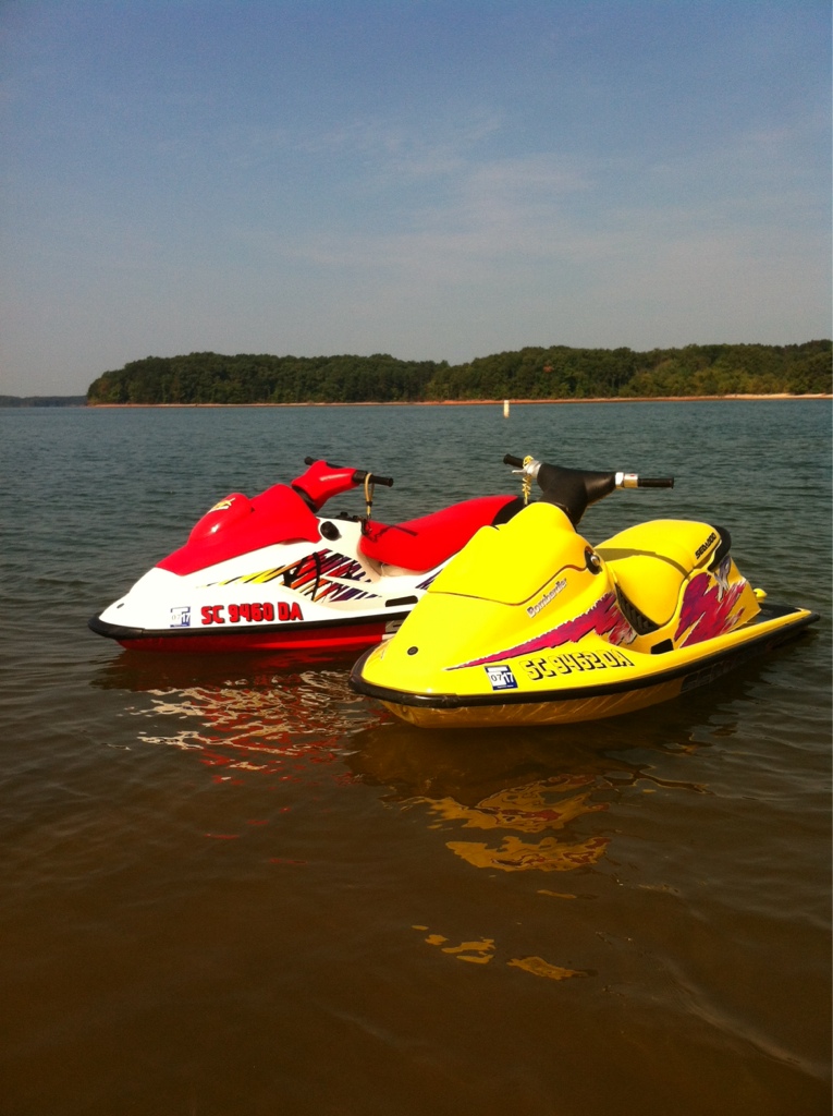

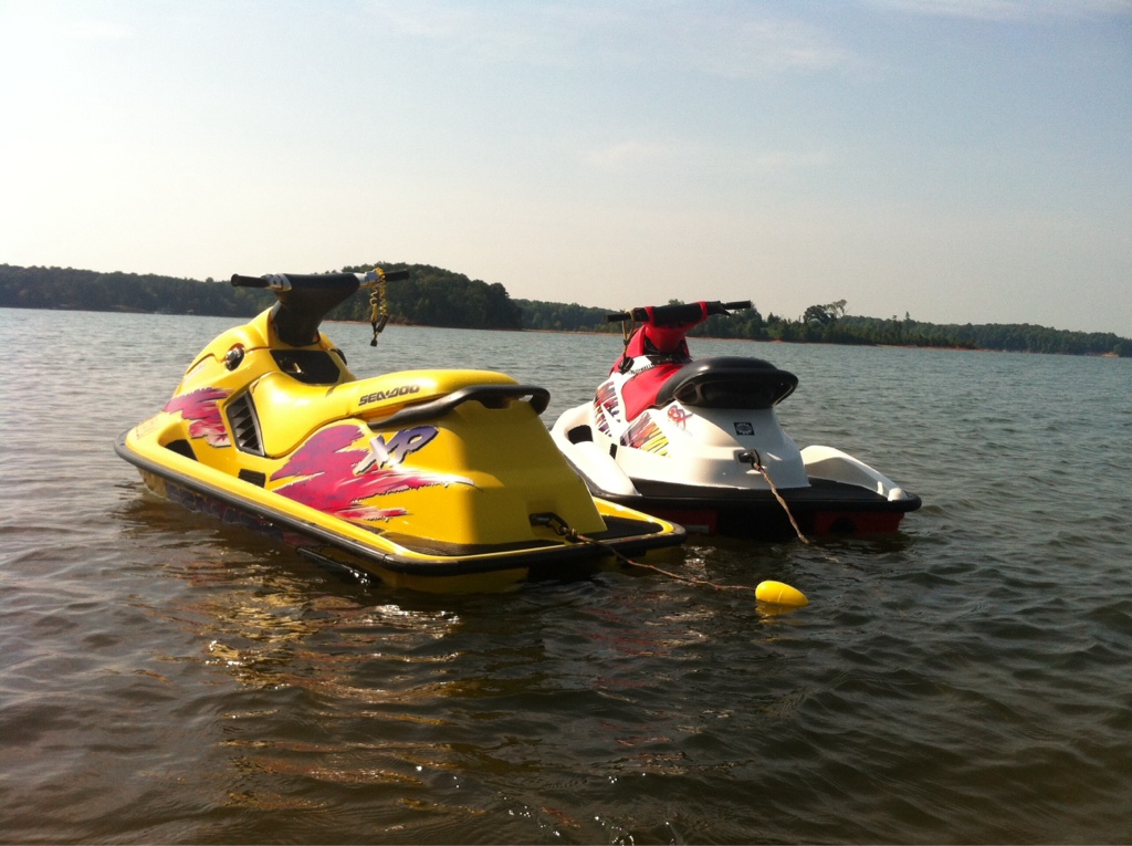

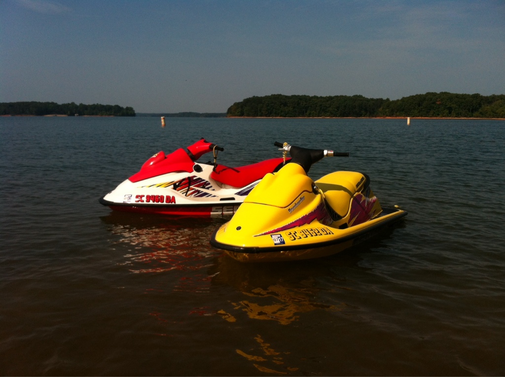

Took the skis out today, wow what a difference sponsons make!
Very predicable turning and it seems to help a bit with stability

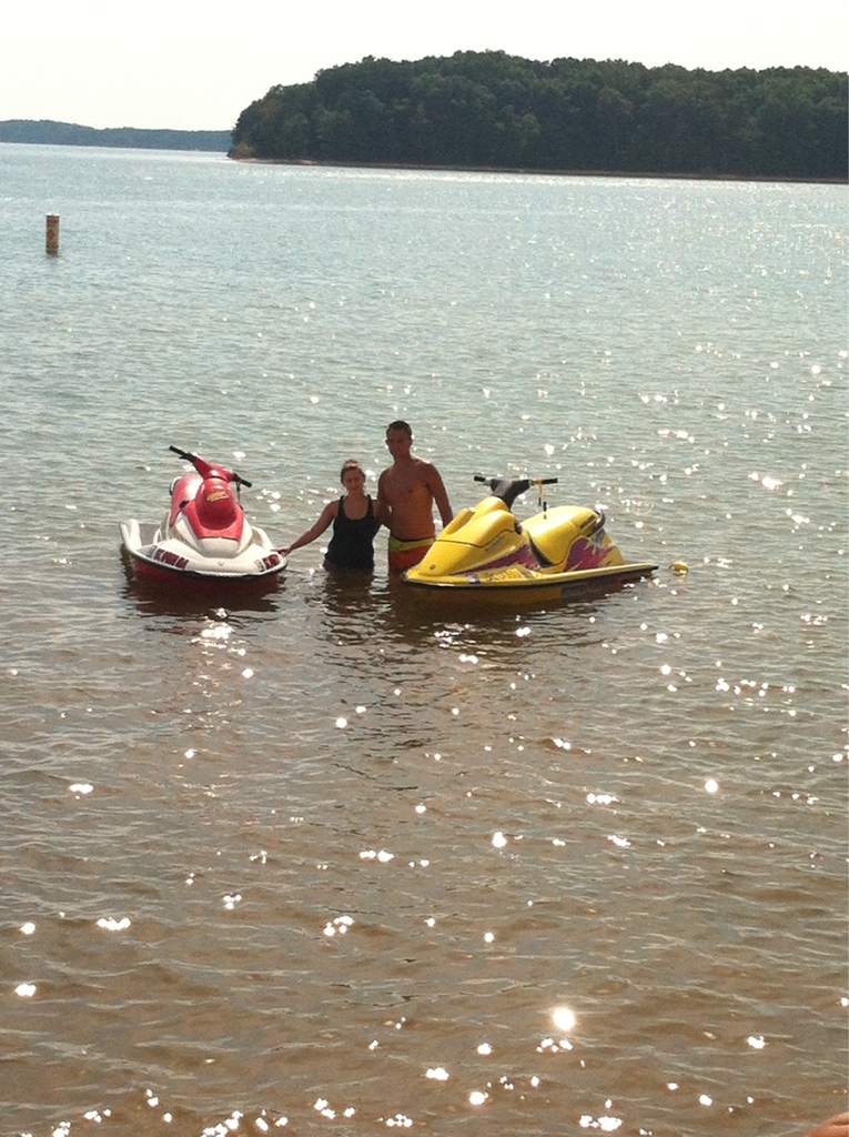

Had a great birthday at the lake Saturday.
Both skis ran great, family enjoyed taking turns on both.
Watching my father-in law getting slung off of the xp and his grin afterwards was priceless
