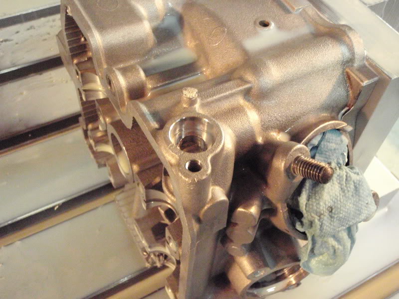

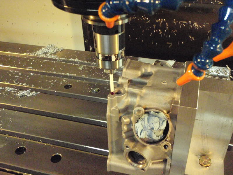

Here's the deal... all of the DRZ's have a de-compression. But... all the electric start versions have a centrifugal weight on the exhaust cam. So... as it starts to spin... it lifts, and fires the engine. It sounds great... right?? Well... the weights have a cross pin that has a tendency of coming out, if you start to spin the engine faster... and KaBoom. So... people building race engines, take them off. Also, aftermarket cams don't have the place for the weights. So... couple that with a big bore, and higher compression... and the poor electric starter can't spin it over.
Now... the problem is... on the S/SM/DS engines... they didn't machine the heads to even put the de-comp parts in. So... when I did my DRZ SuMo build... I decided to make the fixtures, and offer head machining service.

Ahh I see, well that makes sense then. I have never heard of that problem before, I know a lot of people use the DRZ head and cams on LTZ quads. Oddly enough after looking at your pictures, you cleared something else up for me, I have a DRZ head in my garage lol. I bought two LTZ heads from a guy a few months ago, well apparently one was from a DRZ. I was wondering why the hell it had a hole for manual decompression. It dropped two valves and damaged the chamber and valve seats. Do you do any other head work services?

If you want to block off the de-comp hole... I made some plugs. FYI... if the hole is there... that's the "K" head. (The best one) That head came from the Dirt-only, Kick-start head. (best stock flow)

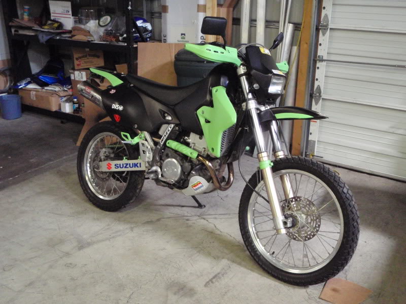

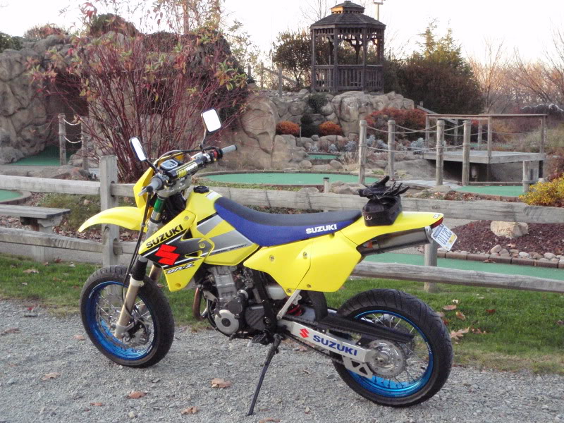

My SuMo Build was GREAT. The factory DRZ SuMo is just OK. They basically built it to be a street bike, and not a true SuMo. So... I took a beat up DS, did a rebuild... put on the 50mm conventional forks from a "K", and a WP rear shock... put in a new crank, and big bore (making it a 467 engine) With K cams, and an FCR carb. (the stock vacuum carb sucks too)
Sorry for the off topic... but here's the before and after.....

Thanks Doc for the info on the DR. Just got it last year and am having a blast with it. Going to the Hootch in north GA in June! Very nice job BTW on the supermoto. Bet that's also fun to ride!

That thing is sick! awesome job on the build, and thanks for passing on the info about the head! Oh and yes, if you don't care shoot me a PM with those shops, I have a few 450r race heads that need a little work too.
