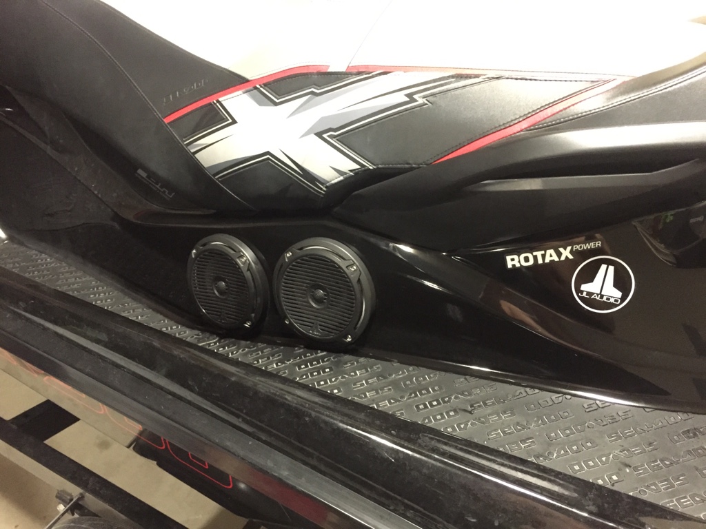

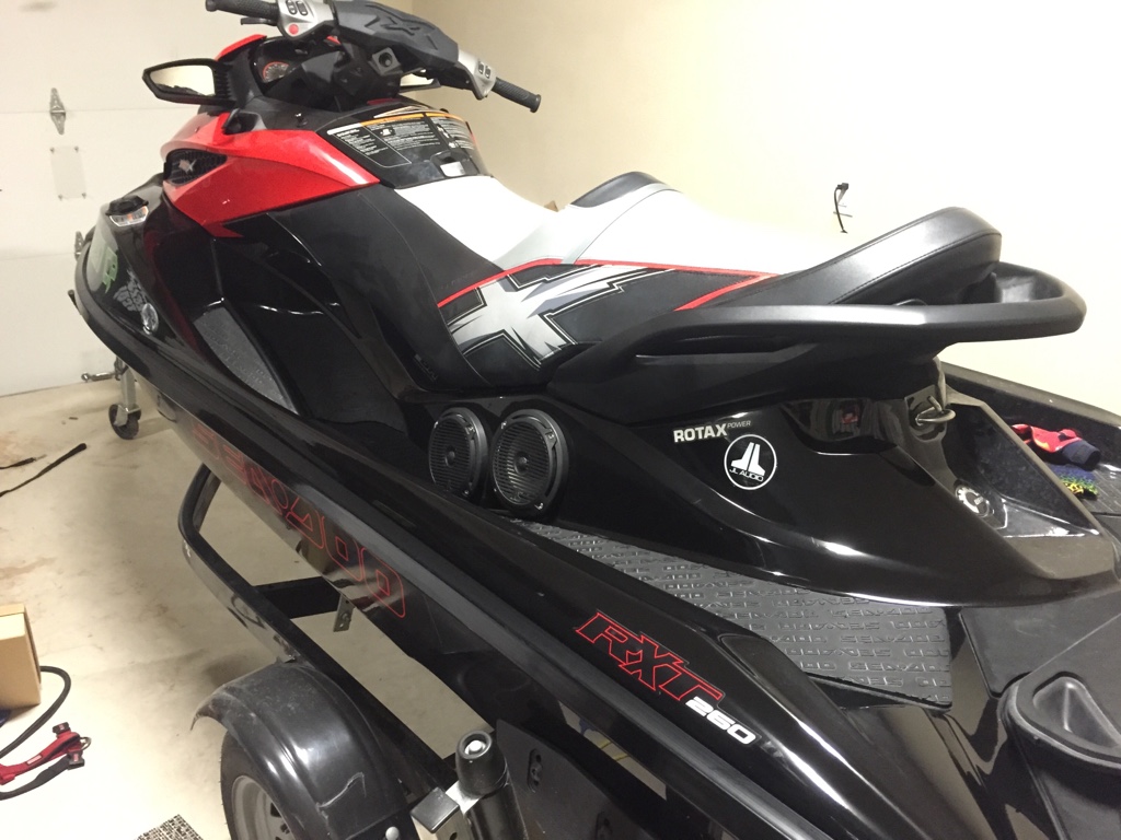

How much are you looking to spend? i installed a 300 watt rockford fosgate amp, 4 JL Audio 6.5 speakers, with the Wet Sounds bluetooth unit and i can hear the music blaring while going 70mph. just let me know if you need a write up. you can always look at different equipment options i figured if i was going to do it you might as well do it big.
[MENTION=73851]Stuetels[/MENTION] Im in flight with wifi, been searching on the items you mentions. What speakers did you go with and where did you mount them. And what Wetsound head did you use. The amp I found. Where did you mount the various parts? Appreciate any input. This is something I am going to do, just want to do it right the first time.. Thanks...

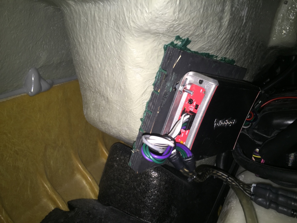

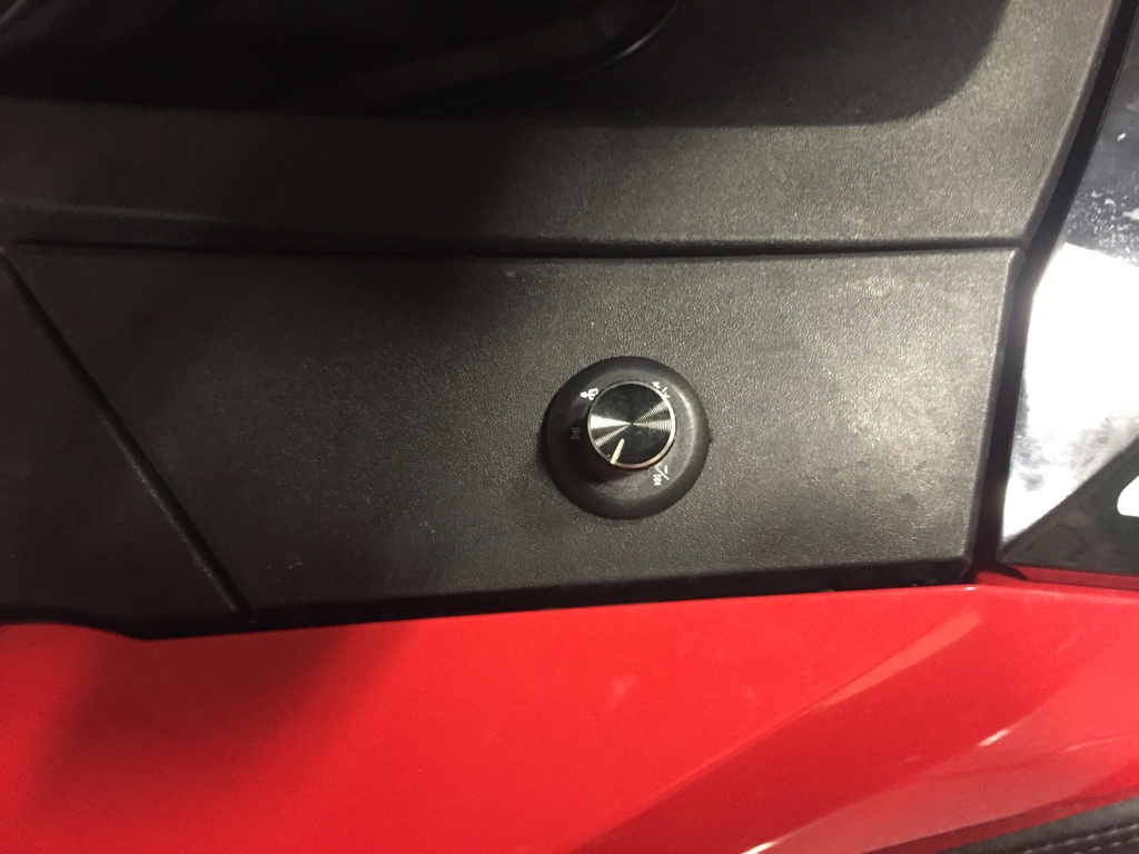

sorry for the dirty ski. So I attached the Bluetooth unit directly to the amp and installed an on and off switch so it still runs when the ski isn't on. https://wetsounds.com/pages/products/WW-VC-BT.html I had a board mounted inside with fiberglass and bolted the amp to it. You have to use bolts. I also did a sound system on my GTI and I used screws the first time and hit a wave it ripped right out. http://www.jlaudio.com/mx650-ccx-cg-wh-marine-audio-mx-series-speaker-systems-91761 painted the faces black. The sound that comes from this system blows people's mines when you pull up to boats in some cases and your the loader person.
